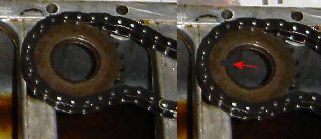

Guest Scartie Posted November 10, 2007 (edited) Can someone tell me how to put the main oil pump sprocket on the crankshaft When i put the sprocket on the crankshaft its lose (and thats not good i think ), and in the hanyes manual its says i have to put in a woodruff key in the crankshaft before putting on the sprocket but i think thats not correct. Can someone tell me if this is correct, and else how its supposed to be? Some pics to clear it up. Thanks in advance Will Edited November 10, 2007 by Scartie Share this post Link to post Share on other sites
Ryan 99 Posted November 10, 2007 On some engines there is a little cutout in the sprocket to make room for a locking key so that the sprocket doesn't just spin loosely on the end of the crank. Some engine don't have this however and just rely on the crank bolt being done up properly to hold it in place. It's a very stupid design. Share this post Link to post Share on other sites
Guest Scartie Posted November 10, 2007 Like this: Ehh ok distribution pulley is wrong. Share this post Link to post Share on other sites
Ryan 99 Posted November 10, 2007 It's on the oil pump sprocket itself (or not if you engine is the type without one). I've drawn it on the one on the right: Share this post Link to post Share on other sites
Guest Scartie Posted November 11, 2007 Ok so my engine is without one. Thanks for the help. Now i can continue with the engine. Share this post Link to post Share on other sites

pee vee 1 Posted November 12, 2007 Its an MI16 engine, so that oil pump drive cog is held on by luck! lol its all held in place by the big (22mm ?) bolt on the end of the crank, once everything is in place.... and yes, i'd do it up tight and glue it in lol. you REALLY dont want it coming undone lol.. Share this post Link to post Share on other sites
