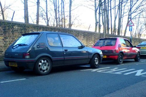

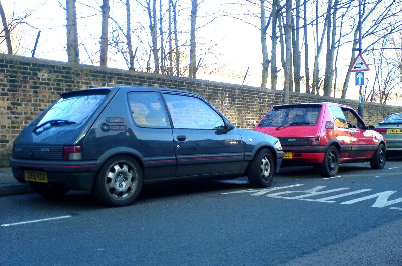

OK, this is my previous 1.6 when it was on standard 1.6 suspension

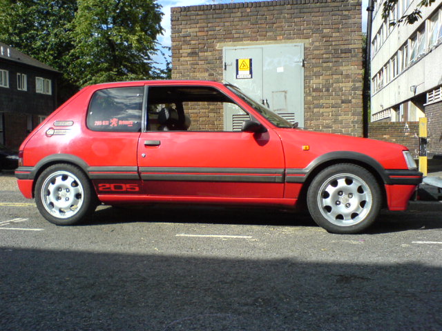

and behind it is my old 1.9. This was on Eibach springs with standard top mount rubbers and the beam was lowered to suit by Anthony (although I always felt it looked very slightly lower at the back. Eibach 7001 IIRC are listed as 35mm lower, but when compared to others that quote that reduction I've always thought the Eibachs seemed a little lower, possibly 40mm.
EDIT: Swordfish's picture sort of proves that Eibachs are in the region of 40mm drop

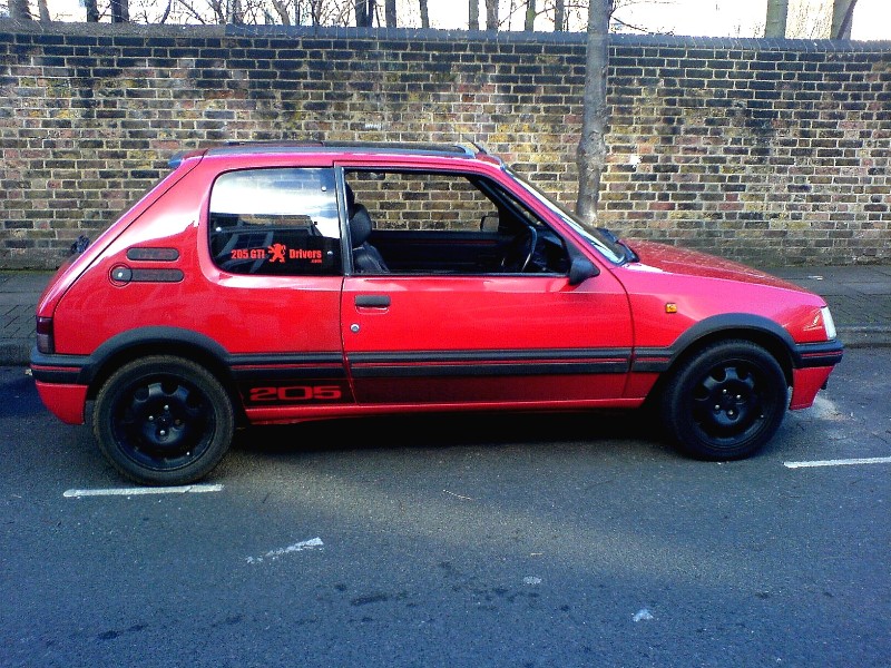

And here is the 1.6 again. This time it has the Eibach 7001 springs BUT with BBM Group N top mount rubbers. Remeber the front wheels stick out a bit more due to 1.6 hubs. Also got 1.9 beam on from the GG 1.9 pictured above.....
