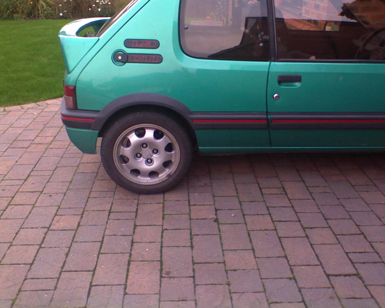

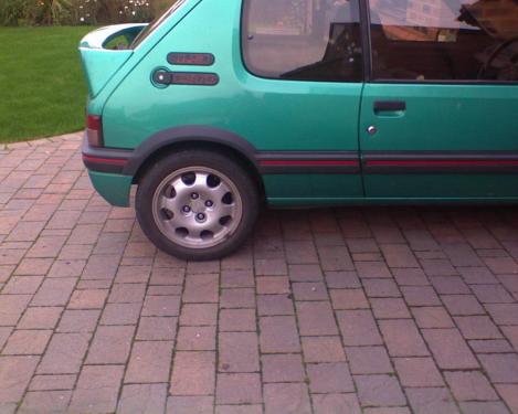

laser green 1.9 0 1 Cars Posted October 14, 2007 (edited) Here's my ride hieght at 322mm Edited October 14, 2007 by laser green 1.9 Share this post Link to post Share on other sites
