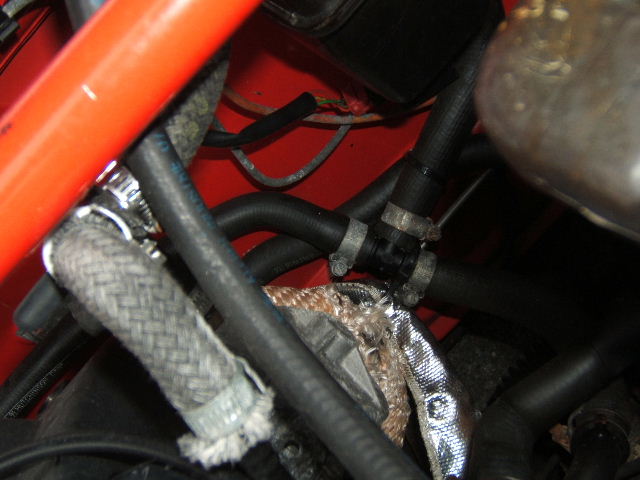

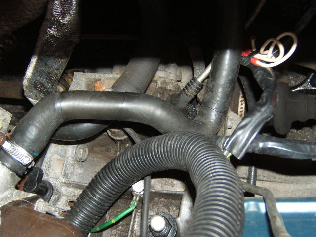

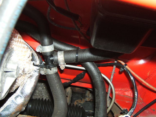

Here's some pics I had saved on my hard drive, unfortunately I can't answer any questions on them as I haven't done this part of the conversion yet. I do know you need to insert a T piece into one of them though,as shown in the one pic.
Hope that helps.

this is mine, i have t'd into the pipe to the stat housing
