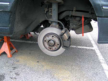

pug_ham 245 3 Cars Posted September 24, 2007 There is a metal pipe in the inner wing that rusts away so it might be that has spring . You can see it in the picture below; Graham. Share this post Link to post Share on other sites

welshpug 1,737 Posted September 25, 2007 of the two pipes at the back of the engine one has a habit of rubbing on the steering column joint if its not positioned correctly, and as Graham mentioned the metal pipe in the wheelarch is a common culprit for pinholes. Share this post Link to post Share on other sites
john-melbourne 6 Posted September 25, 2007 Just from the positioning of the leak i would say its one of the two pipes that eveyone has said to check, where does the rubber on that metal pipe lead to as that looks like it is heading in the right direction. John Share this post Link to post Share on other sites
large 33 Posted September 28, 2007 It runs from the back ok the block(it is one of the two i was on about) and the other end is to the bottom of the rad. Share this post Link to post Share on other sites
