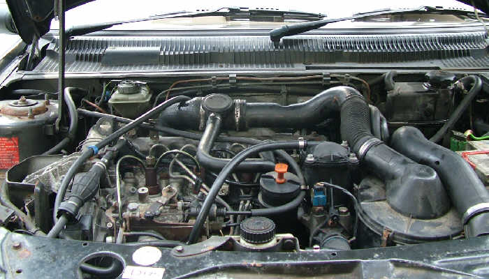

pug_ham 240 3 Cars Posted September 21, 2007 In the last 1 1/2 hours I've done a few checks & I think I've found my problem. First of all I tried cranking it just in case but it didn't start so I cracked the injector pipes, fuel seeped out straight away & then cranked it over, fuel is getting to the injectors fine so imo that rules out the stop solenoid & hopefully the pump. (It ran fine with no power loss right up until it died completely.) I then took the rocker cover off to check for the worst of a snapped cam. All is fine, actually nice & clean for a 160k engine. I figured with the rocker cover off I'd check my valve clearances as one of my previous n/a 205 diesels suddenly lost the will to run smoothly & these were the problem. The results; Inlet; should be between 0.01' & 0.025'. Exhaust; should be 0.025' - 0.040'. #1 cylinder. Inlet = 0.001' Exhaust = 0.005'. #2 cylinder. Inlet = > 0.001' <0.0015'. Exhaust = 0.01' #3 cylinder. Inlet = 0.0045' Exhaust = 0.01' #4 cylinder. Inlet = 0.0045'. Exhaust = 0.01' Unless I'm doing something seriously wrong measuring the clearances, I think thats the cause. Cam is coming out over the weekend & I'll get some new shims made up next week. Are the XUD's well known for suddenly loosing the valve clearance's? This is the second one its happened to for me. I'll report more once I've done. Graham. Share this post Link to post Share on other sites
pug_ham 240 3 Cars Posted September 22, 2007 I was speaking to my local Pug parts dept today & they said it does sound like an air leak somewhere before the pump. The head for the filter set up fitted to the 205 STDT is £100 (its still available ) but I got all the bits to change to the small head mounted filter set up today, looks about two hours work but I need to get some fuel pipe to run from the rigid at the back of the engine bay to the priming pump ball on this set up. I now realise its not the valve clearances that are to blame but I want to set them properly now I've discovered they are that far out & seeing as I've got it partially stripped I'll do them now. Graham. Share this post Link to post Share on other sites

pug_ham 240 3 Cars Posted September 29, 2007 Its not running again yet but it's getting very close. I just need a different oil strainer neck to allow for the different placment of the cold start cable on the new style thermostat housing I'm fitting which I should've got today but didn't. The thermostat housing I got last week was from a 306 which I though might explain why it didn't clear the breather offtake at the back so I went back to the scrapyard I got the bits from last week & they had got a 205 diesel in since then (L reg 68k:o) so I swapped the 306 bits for the 205 ones but I should've got the strainer neck. Got the proper priming bulb hose as well with the straight fitting instead of a 90' one. Got hom,e & removed the oil fuel pipes from the back of the engine bay to the water heater & up to the old filter. I think I've found the cause, the rubber hose from the heater to the filter had perished severly & was cracked I found out when I removed it so it would be letting air in. All new pipes fitted now so once I've got the strainer neck it should be done in a few hours on Tuesday. Looks much neater already with the later thermostat housing & fuel piping. Gaham. Share this post Link to post Share on other sites
pug_ham 240 3 Cars Posted October 2, 2007 Good news, its fixed & back to smoke again. Turns out it was simply the fuel pipe that had perished/ cracked & was letting air in. Got it all back together this morning but the thermostat gasket was leaking (when cold & unpressurised) so I drained the cooling system again & took the cap off. My own fault as I swapped the cap for on with an oil water heat exchanger pipe offtake & didn't fit a new gasket. My local Citroen garage didn't have a thermostat gasket in!! Luckily I had one that had only been used for a couple of weeks on my GTi so I used that & its sealed fine now. I'm going to put a few miles more on it driving to work this week & then look at doing the valve clearances soon. Under the bonnet looks much better than previously. I used a 306 oil strainer & dip stick instead. I've also got the new 106 S2 Rallye wheels fitted but it was to late when I got in from the 40 mile test drive today to take a photo. I'll take one soon, they are almost glowing they are so white. Graham. Share this post Link to post Share on other sites
