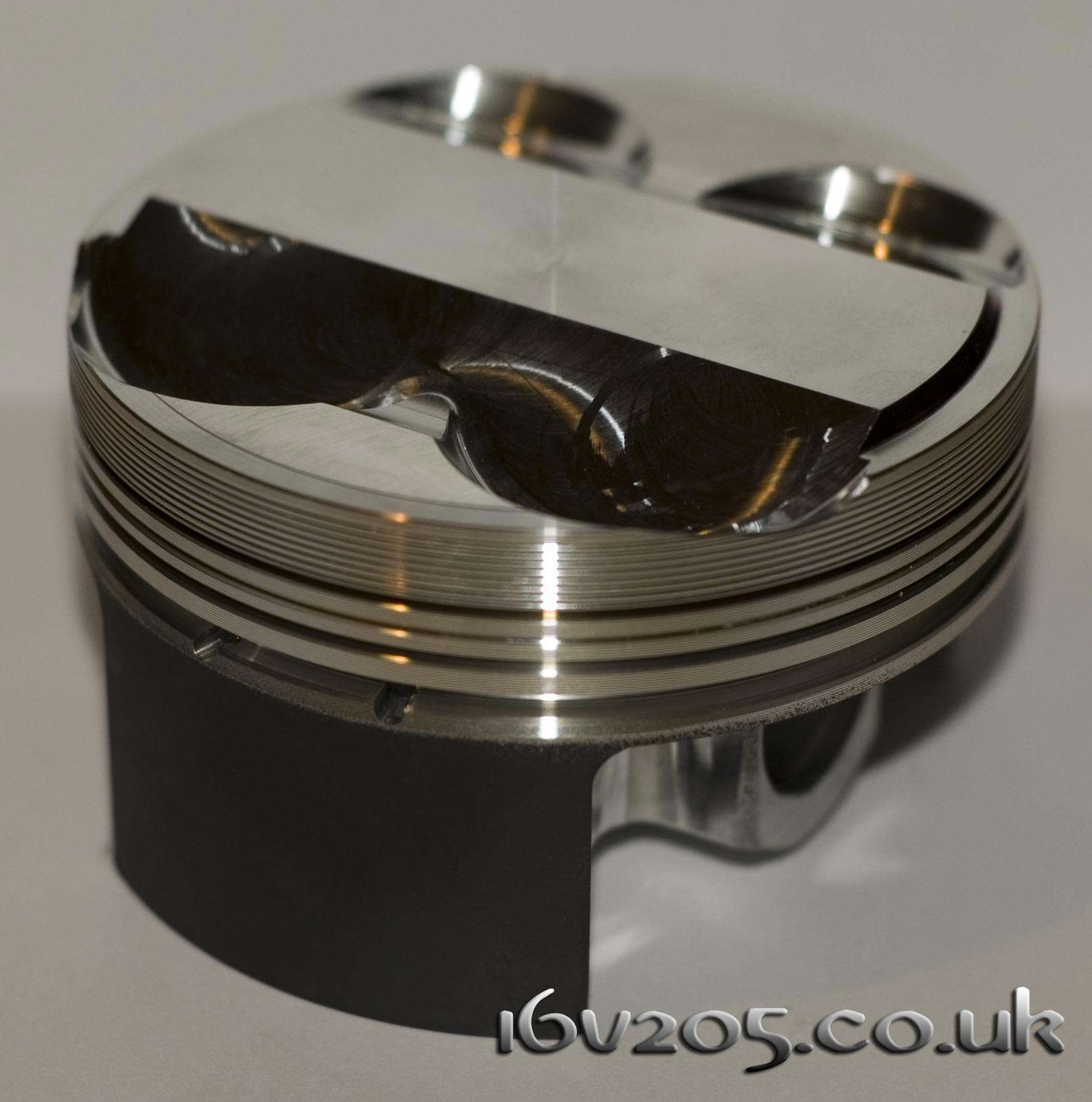

16v205 9 Posted December 20, 2007 Got some pistons eventually . I know it wasnt the companys fault I originally ordered them from but I wasted a whole year nearly so can now get my finger out and start building the engine in the new year. Pistons came from Wossner, purchased through BB Performance Tuning. They turned up 3 days later than the 6 weeks that was quoted. Their custom made 88mm forged gti-6 pistons, 11.5:1 compression, gudgeon pin height has been moved 1mm to allow the use of a mi16 crank. Rings, gudgeon pins and circlips are all available next day off the shelf. Complete weight of a single piston inc rings and pin & circlips is around 470grams give or take a few grams as im only using a cheap set of scales. Im impressed so far with the service and the quality of the parts, just cant wait to start building my engine Rich Share this post Link to post Share on other sites
Baz 421 Posted December 21, 2007 Nice! Comparibly priced Rich? Share this post Link to post Share on other sites
