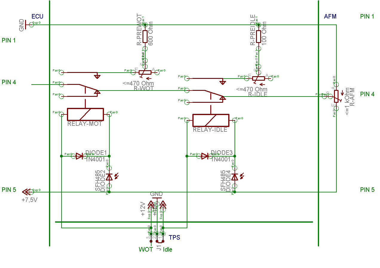

Dandu 0 Posted August 12, 2007 Hi, just to give an impression of my very simple piggyback system (influencing the AFM-voltages at idle and wot): If someone is able to figure out any kind of mistake ... I'd appreciate his comment. Thanks in advance. Bye Dandu Share this post Link to post Share on other sites
Dandu 0 Posted August 25, 2007 Hi, just to report my experiences. I've managed to set up my simple piggyback-system. The final version is a bit different from the version above. Some major faults had to be corrected. And now ... it's running. The AFM (that means the spring) is adjusted to deliver the "proper" amount of fuel at WOT. In dependence of the TPS-signal additional variable resistors are actuated at POT and IDLE. The current configuration is as follows: IDLE: 0,92 Lambda POT: 1 Lambda WOT: 0,87 Lambda. At a first glance it seems to be ok, but there is a small problem. At WideOpenThrottle the Lambda-value is jumping. The scenario is as follows: Driving along in 4th gear steady at 3500 rpm, smashing down the gas pedal, the pointer passes 4000 rpm -> Lambda 0,87, 5000 rpm -> Lambda 0,87, suddenly Lambda goes down to 0,70, as quick as it came it goes up to 0,84 again and doesn't change as long as the pointer goes to the limiter. Why does the engine seems to overfuel for a moment? Does it have to do with the inner sanctum of the AFM (the design of the sliding board)? Bye Dandu P.S. Hey Damir, did you experience the same at higher revs? Bytheway .. your recommendation to buy a wide-band oxygen sensor was very helpful. Much thanks again! Share this post Link to post Share on other sites
