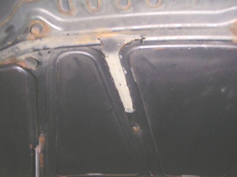

As for the bonnet, I trimmed a small section out of the strengthening bar on the drivers side, now the bonnet shuts properly B)
Here's a crude pic of the trimmed section, will tidy it up.

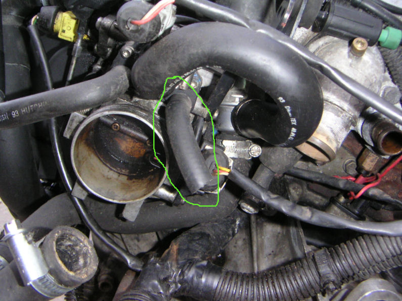

Does anyone know what the greeen circled hose is for on the throttle body of the 2.0 mi16?
pug309twin40s
that originally would have been connected the the 405 airbox or piping
i had it left disconnected when i was first using the s16 engine in my goodwood but then connected a hose from it to the induction kit piping.
Gibbo GTI
Cheers, will leave it as is then. Wasn't sure if it was a coolant hose to the throttle body like the gti has. Should hopefully have the downpipe tomorrow and maybe have it running tomorrow night :huh:

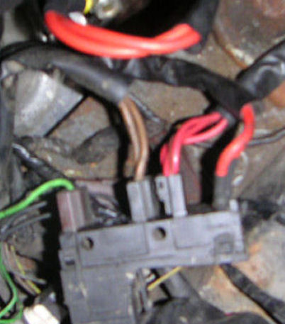

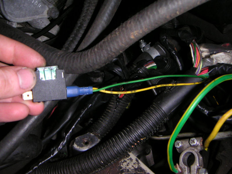

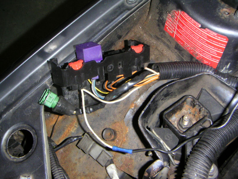

Forgot to add last night (too tired) these pics showing constant live, switched live and fuel pump live. Ive connected the earths to the gearbox and the chassis in the same place they were originally (using BE3 box).
The Fuel pump live is from wire 121
The wires I connected to a switched live in the pic are CC8 (yellow) and 882 (green), they came as per pic

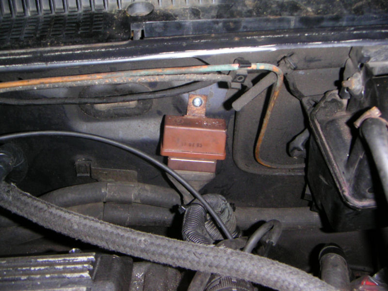

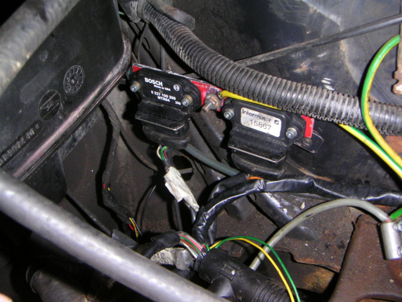

And a pic of the ignition amps and injection double relay. I earthed the bar the ignition amps are on direct to the battery -ve.

The clicking was from the injection double relay which would explain why the voltage at the fuel pump connector was alternating. Unfortunately I haven't been able to charge the battery today as the power at work has been off today and is off tomorrow. Good for us to have the time off but crap for sorting my car out lol.
allanallen
not certain of this but i thought the ignition modules had there own earth (wires) and were insulated from the bar they are mounted on. I had alot of trouble on my conversion and it turned out to be the earths to the modules. Best to wire em straight to the battery.
Gibbo GTI
There's no earth wires coming out of the loom close to the amps unless its the ones that go to the gearbox earthing point. They are bolted down tight and the battery -ve is connected to them as well.

pug309twin40s
there should be a smallish earth wire coming from the ignition amps, that needs connecting to the negative on battery to make sure they work,
then there should be another earth wire by the main connetion end of the loom(where the CC8, fuel pump wires) are.
then just the 4 main red live wires(which you have connected already to power block,
then the CC8 and fuel pump wires then it should run
Don't recall seeing any unconnected wires around the amps. I take it that it would go to pin 4? (earth) on the amps. I will have another look next time i'm on the car. Will also disconnect the amps and conn check the earth line on the amp connector to earth and run a new one if its o/c.

i'll check where the earth wire connects to near the amps on my loom and check the other earth wire and see if theres a number on it.
