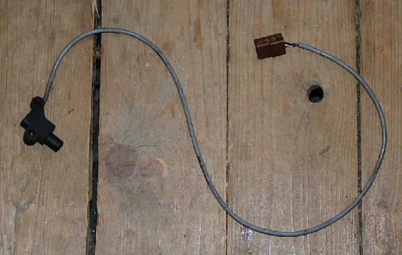

pug_ham 245 3 Cars Posted July 22, 2007 It fits in a rubber mount in the flywheel casing at about 5 past the hour looking at it from the nearside wheelarch.The location is about right but mine isn't mounted in a rubber mount, the mount is plastic. The attached picture is my new one waiting to be fitted to my STDT to hopefully fix the lifeless rev counter. They are approx £15 from Peugeot & sometimes can be fitted easily but mine doesn't work even with the new sensor fitted with the gearbox on so I'm going to set it correctly when I swap the gearbox in the next bowt of dry weather. The sensor you've seen is more likely to be the revsering lamp switch in the area you mention imo. The crank sensor is towards the back of the engine / gearbox mounting face. Graham. Share this post Link to post Share on other sites
edthedrummer 0 Posted July 22, 2007 Okay, thankyou, i will have a look on monday when i am down at the car. You say yours doesn't work even with the new one on? How do you set it properly? I presume its a gearbox off job? Share this post Link to post Share on other sites
pug_ham 245 3 Cars Posted July 22, 2007 You say yours doesn't work even with the new one on? How do you set it properly? I presume its a gearbox off job?IMO you should be able to do it without taking the gearbox off but I haven't managed it yet. Peugeot obviously can though. You fit the new sensor into the plastic holder & there are tabs on the end that you push so they are resting hard against the flywheel. When you turn the engne over again the flywheel timing tooth chops these down to the right clearance & it should work but mine didn't. Graham. Share this post Link to post Share on other sites
edthedrummer 0 Posted July 25, 2007 IMO you should be able to do it without taking the gearbox off but I haven't managed it yet. Peugeot obviously can though. You fit the new sensor into the plastic holder & there are tabs on the end that you push so they are resting hard against the flywheel. When you turn the engne over again the flywheel timing tooth chops these down to the right clearance & it should work but mine didn't. Graham. Where does the other end of it go? Seems like a fairly straight forward task in theory, but i doubt it will be that simple. Thanks. Share this post Link to post Share on other sites
