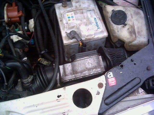

Gtiracer 0 Posted July 18, 2007 here you go, heres mine Share this post Link to post Share on other sites
jackherer 543 Posted July 19, 2007 here you go, heres mine Thats a 405 Mi16 hose, if you have a BX 16v engine that hose is a bit longer so you have to relocate the washer bottle. Share this post Link to post Share on other sites

Gtiracer 0 Posted July 22, 2007 Thats a 405 Mi16 hose, if you have a BX 16v engine that hose is a bit longer so you have to relocate the washer bottle. It is from a BX gti buddy, have a look thru akroblade954's old post's thats who i bought the car from, even have the donor cars log book slip in my file for the car so it almost definately did, maybe somethings been messed about with i dunno? Share this post Link to post Share on other sites
Baz 421 Posted July 22, 2007 It is from a BX gti buddy, have a look thru akroblade954's old post's thats who i bought the car from, even have the donor cars log book slip in my file for the car so it almost definately did, maybe somethings been messed about with i dunno? The engine may well be from a Bx, but your hose coming from the throttle body to the AFM is definitely a 405 one rather than a bx one Alex, that's what Kieran meant. The Bx one is longer and doesn't really have any give/flex in it like the 405 ones. Share this post Link to post Share on other sites
jackherer 543 Posted July 23, 2007 The engine may well be from a Bx, but your hose coming from the throttle body to the AFM is definitely a 405 one rather than a bx one Alex, that's what Kieran meant. The Bx one is longer and doesn't really have any give/flex in it like the 405 ones. Exactly. The loom and throttle cable attachment are clearly from a BX so I agree it is most likely a BX lump but you've definitely ended up with a 405 hose at some point, by the sound of it while the engine was still in the Citroen, I'm not sure how well it would have fitted the standard air filter but maybe they used an induction kit. Share this post Link to post Share on other sites
