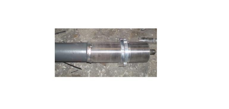

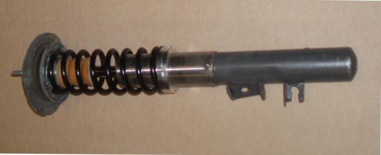

jerseypug 1 Posted June 30, 2007 just put this diy kit together, has anyone had any problems with this type of kit? i used 180 lb springs to keep it close to standard and should be able to easily adjust the ride height when fitted to the car. Share this post Link to post Share on other sites

max0 5 Posted June 30, 2007 just put this diy kit together, has anyone had any problems with this type of kit? i used 180 lb springs to keep it close to standard and should be able to easily adjust the ride height when fitted to the car. the top nut can be hard to do up if they are adjustable. I had to borrow a impact gun to do mine. Share this post Link to post Share on other sites

Miles 331 1 Cars Posted June 30, 2007 You can get the kit from Demon Tweeks and other places I expect, The hardest part is removing the old damper insert on the 205 and the new bushes needed to stick a new one back in, You could just get a front Sprintline Damper I think and mod it externally Share this post Link to post Share on other sites

jerseypug 1 Posted June 30, 2007 got the kit from demon tweeks, think they are £25 per strut. allready had the springs from some gaz coilovers, i used 180 lb springs and did not change anything with the dampers. just finished the other one and it took just under 1 1/2 hours. Share this post Link to post Share on other sites

jerseypug 1 Posted July 2, 2007 so you're not using inserts then ? have you just welded to the body of the shock absorber? when i cut the old spring plates off i left the weld around the strut that the threaded tube now sits on. i put a few tack welds onto it but only to stop it turning when adjusting the ride height. Share this post Link to post Share on other sites

welshpug 1,722 Posted July 2, 2007 so you can have coilovers but not the really hard rallycar like ride? cooool so its as simple as removing the spring pan, sliding the threaded sleeve over and tacking it in place, then fit the spring, tp mount and off you go? Share this post Link to post Share on other sites

Richie-Van-GTi 81 2 Cars Posted July 4, 2007 does that sleeve part cover the end of the strut? Id be inetrested if I could fit a set to my adjustable koni shocks so I get adjustable height/stiffness of spring alongside the adjustable shock. Share this post Link to post Share on other sites
Bats 0 Posted July 4, 2007 just put this diy kit together, has anyone had any problems with this type of kit? i used 180 lb springs to keep it close to standard and should be able to easily adjust the ride height when fitted to the car. That looks like a standard top mount plate. Are you using a rosejoint in the top mount? Share this post Link to post Share on other sites
jerseypug 1 Posted July 7, 2007 using 8 inch springs which are 40mm lower than standard ride height and adjusted about half way up the threads so i can raise or lower more if i like. put them on a 309 just to try out and have been going down bumpy tracks and all is ok. i have used standard everything apart from the springs, spring holder and threaded tube. the sleeve covers the end of the strut by about 30mm. Share this post Link to post Share on other sites
snillet 1 Posted July 7, 2007 using 8 inch springs which are 40mm lower than standard ride height and adjusted about half way up the threads so i can raise or lower more if i like. put them on a 309 just to try out and have been going down bumpy tracks and all is ok. i have used standard everything apart from the springs, spring holder and threaded tube. the sleeve covers the end of the strut by about 30mm. Although i´ve read som things about the stability of the whole strut assembly being less good with these conversions because the "stock" spring seats are mounted at an angle to stabilize the damper, this sounds very good to me since i´m trying to achive a "low budget" combination of usable car on both track and as a daily driver. Not very costly, at least not the sets sold at rallydesign. Will have to give it a shot i think Share this post Link to post Share on other sites
