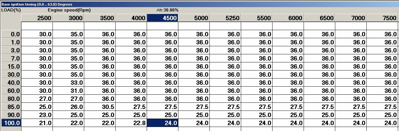

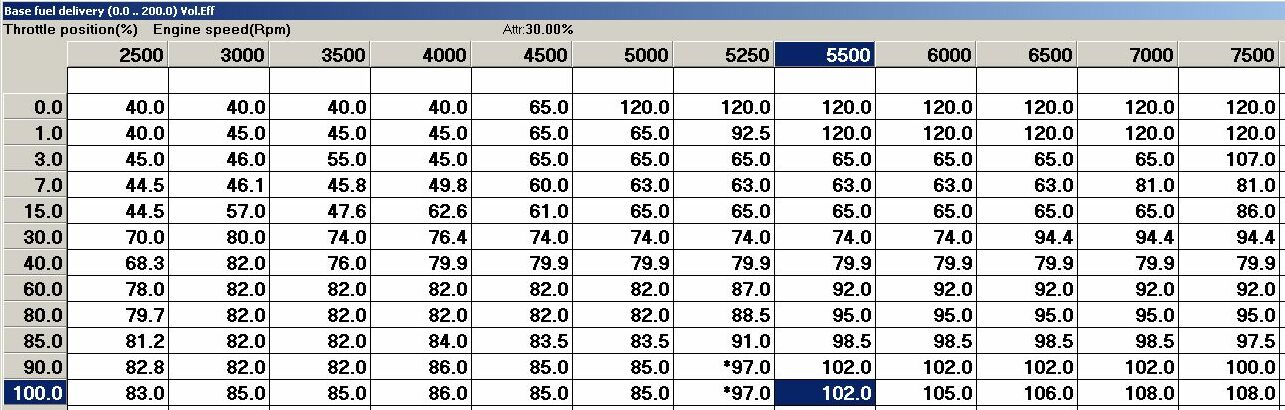

petert 554 Posted May 25, 2007 I spent some more time on the dyno today fine tuning my new engine. I spent condiserable time holding at each load point (the important ones anyway) and confirming the mixtures. After that I decided to do a power run vrs mixtures to see the outcome. To my surprise there was still a nasty rich - lean dip at 500-5500 as it came on the cam. Inspection of the fuel table at 100% throttle opening shows 5000 had a value 85 to produce 12.9:1 and 5500 had a value of 102 to produce 12.9:1. Hold them steady at those points and the mixtures were fine. However, on the power run, where you move through the points, there was spike to 13.4:1. The only way to solve the issue was to add another axis at 5250. If your software doesn't allow you to add an axis, then there's no chance of ever improving on that type of situation. Then take a look at the ignition table, in particular from 2500 to 4000 at 100% load. Load in this case is by manifold pressure. Those values were originally 24 degrees. However, while I was watching the torque readout, I used the + and - keys to adjust the timing. It was surprising how much the torque INCREASED by a decrease in a few degrees. The resolution for a highly tuned engine is important. Notice in this case it's to a tenth of a degree. Again, that's what you pay for. I also concentrated on 3500 - 80%, to check the cruise timing. I had this value originally at 30 degrees. As I held the + key down the Nm just kept on climbing, until they peaked at 36 degrees. I didn't have time to do the full table, so I filled in the rest at 36. Share this post Link to post Share on other sites

petert 554 Posted May 25, 2007 I didn't think this had loaded due to an internet slow down, so went to the club, and thus hadn't added the screen shots. Here they are: Share this post Link to post Share on other sites
