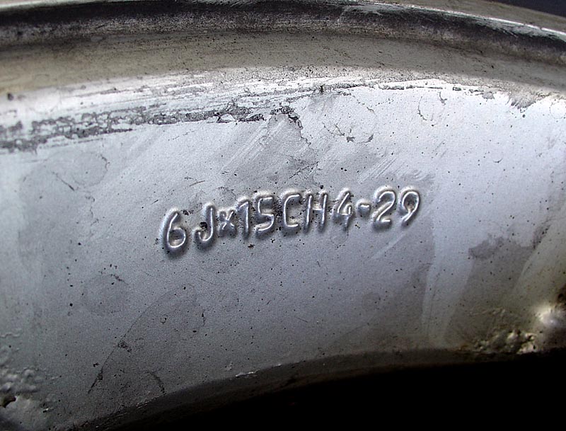

Baz 421 Posted May 25, 2007 Have wondered myself in the past, but put off by the fact they're et29, and would need around a 10mm spacer for them to fit correctly. Share this post Link to post Share on other sites

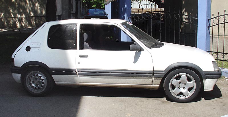

5150maxie 0 Posted May 29, 2007 has anyone got any pics of the mi16 wheels on a 205? Share this post Link to post Share on other sites

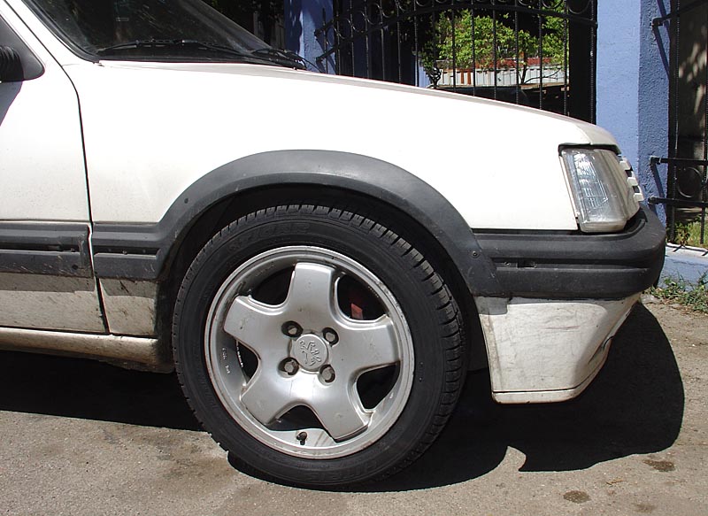

cybernck 424 1 Cars Posted May 29, 2007 a friend has put a set on last week - he didn't have to use spacers for the front ones, as his 205 GTI is a 1.6 and has a little bit wider front track, while for the rear wheels he used the old front discs' faces (machined the rest off) which spaced the wheels 7mm out and it doesn't rub now (he used longer wheelbolts ofcourse). i'll have to take some pics with all 4 wheels on and the car washed - looks pretty good . hope this helps. Share this post Link to post Share on other sites
5150maxie 0 Posted May 29, 2007 thanks they look really good .im going to paint mine in antherite and possibly 10mm spacers.what wheel bolt size do i need and wheres best to get them from? Share this post Link to post Share on other sites
