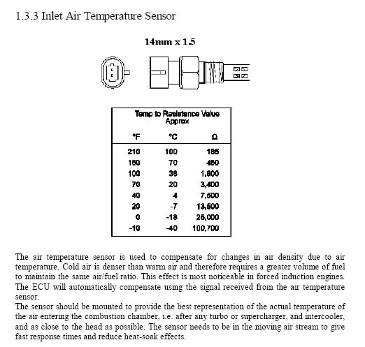

petert 614 Posted May 20, 2007 I just made an air temp sensor using an LM335. It's not even rocket science. That may not work for you however. Here's the GM sensor which Haltech uses. If that's close there's probably a heap at the local wreckers. Share this post Link to post Share on other sites
Sandy 191 Posted May 20, 2007 Lucas SNB802 is widely used and easy and cheap to source. Has pretty much the same curve as the 2.4k Bosch. Share this post Link to post Share on other sites
Scottieb 0 Posted June 4, 2007 NTC means Negative Temperature Coeficient. this means that the sensor resistance decreases as the temperature rises. You just have to find antother sensor witht the same resistances at given temperatures as yours. if you lookt at the datasheet for the sensor it should give you a graph of resistance plotted against temperature. KMS should be able to give you this information for thier sensor. Then you just have to find another sensor witht the same curve. Here are the sensors I use, I've never had any probs: http://uk.farnell.com/jsp/Passive+Componen...jsp?sku=7119100 http://uk.farnell.com/jsp/Passive+Componen...jsp?sku=7119094 Share this post Link to post Share on other sites
