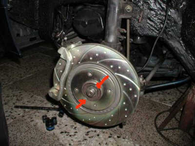

pug_ham 242 3 Cars Posted May 8, 2007 If your car has the ABS system fitted I think you'll need the driveshaft from a 1.9 GTi to replace it. To check if your car has 1.9 hubs fitted have a look at the driveflange, there should be two opposing cut out's it if its a 1.9 hubs(see attached image). The 1.6 GTi's are solid. Surely if you order the wrong one you'll be able to exchange it for the correct one anyway? Graham. Share this post Link to post Share on other sites
