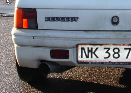

This is what my 70mm supersprint looks like. It is actually quieter then the standard one that I had.
