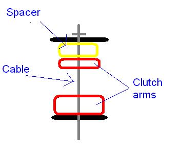

Now I need advice.
Clutch cable?
205 clutch is pull and 405 is push as I can see it from cable arrangement.
- how do I convert cable to fit and work wiht 405 clutch ( I know I should have kept the original cable and fittings from 405.
PsychoSimon
The clutch cable you already have will work, if you space it. IE at the moment it won't adjust down far enough to even get close to touching the bracket and release arm. I made a nylon spacer to take up any excess space either side of them. You could use a socket etc temprarily i suppose.
Also if you're using the top mount intercooler, you won't be able to use that black rubber bit that goes on top, and if you have to sit in traffic the you will find it very flat afterwards, because the heat "soaks" the intercooler. I was gonna go for a front mount but got a bit ambitious with my boost and fuel adjustments and made a nice bang with some smoke lol :P

foreigner
Thanx for the clutch advice.
I kind of worked it out similar as you said. I am going to my local scrapy tomorow to get similar spacers so it doesn't slip I used springs from exhaust as temporary measure.

inferno
ive used the above clutch bodge when fitting a gti 6 box, just source spacers off another car.
any local garage would take your exhaust on, but as i said in your wanted, if u cut it to size ill weld it up when u come over next time.
to save the bodging use the clutch release mechanism off the old gti box on the new TD unit.
