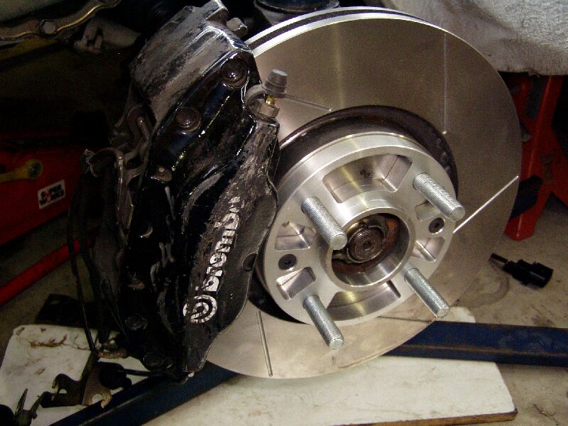

fitted set 2 my car & required @ 20 / 30 mm spacers to stay using the 1.9 alloys on 1.9 hubs, also used my willwood 285 discs

ak 205
They fit very nicely with the 307 disc. I just need one more caliper. Does anyone have a spare one?
nice studs & spacers there petert , what size & where could i get some from thanks . also what wheels will u be using
