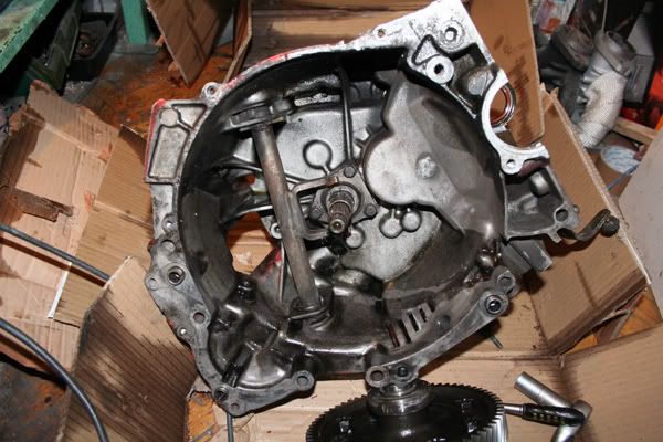

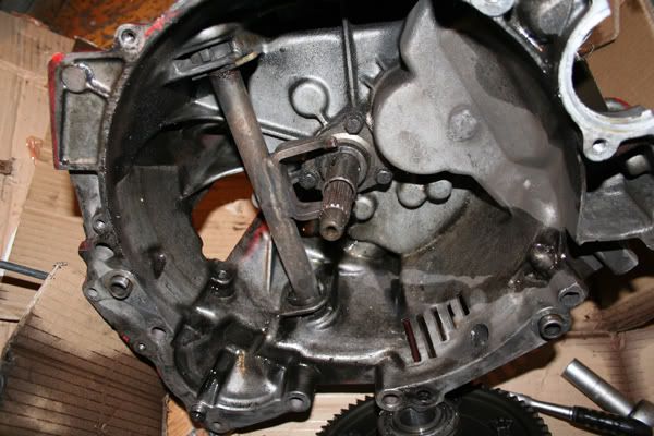

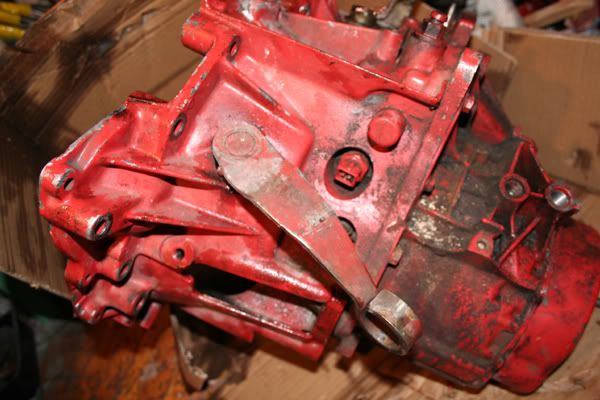

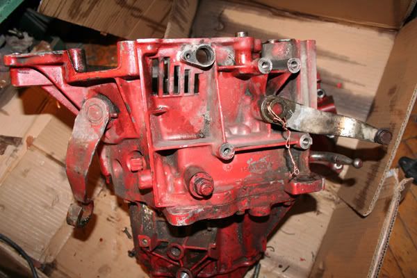

DamirGTI 362 Posted March 15, 2007 Hello ! Please can somebody identify this gearbox : http://i27.photobucket.com/albums/c151/Pie.../Picture111.jpg http://i27.photobucket.com/albums/c151/Pie.../Picture112.jpg http://i27.photobucket.com/albums/c151/Pie.../Picture113.jpg http://i27.photobucket.com/albums/c151/Pie.../Picture114.jpg http://i27.photobucket.com/albums/c151/Pie.../Picture115.jpg gearbox code is 14DS1 and 16x65 mark stampt on dif. it was teaken from 405 mi16 but guy sead that it has a bit wierd long ratios for that car .. i'm 100% sure that it isn't mi16 gerabox , maybe diesel or SRi box.... clip (405 1.9mi16 with this gerabox): Thanks Share this post Link to post Share on other sites
Miles 331 1 Cars Posted March 15, 2007 The case isn;t a Mi just a normal 8v one, so with it being 16x65 it would be either a 405 SRi or 205 GTI but the latter will have short ratio's Share this post Link to post Share on other sites

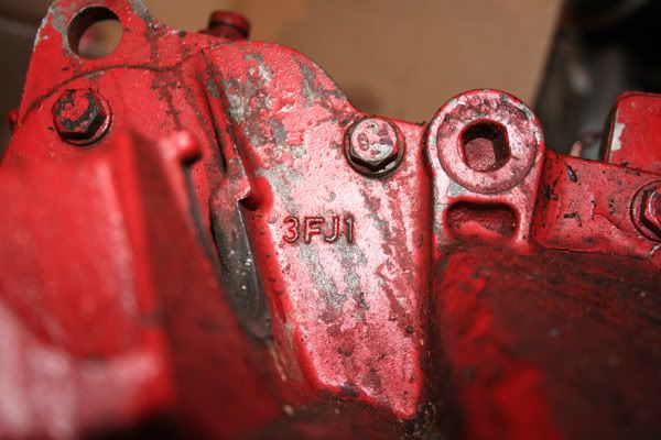

DamirGTI 362 Posted March 15, 2007 ok. But can it bee diesel gearbox ? diesels have 16x65 dif. also i have found two more marks if they mean something : http://i27.photobucket.com/albums/c151/Pie...is/IMG_4513.jpg http://i27.photobucket.com/albums/c151/Pie...is/IMG_4515.jpg Share this post Link to post Share on other sites
pug_ham 245 3 Cars Posted March 16, 2007 But can it bee diesel gearbox ? diesels have 16x65 dif. also No, the 16 x 65 diff makes the final drive 4.063 which makes it the same as the 1.6 GTi or a 405 SRi like Miles said. The other two pictures don't highlight any other marks that could get you closer to identifying the gearbox but if it has long ratio's (although only in 4th & 5th) I'd say its the 405 SRi gearbox. Graham. Share this post Link to post Share on other sites
DamirGTI 362 Posted March 16, 2007 Bump.. Anyone else maybe ? diesel or not ? Is there any other way on which i can identify this gearbox ? if i count teath on 5-th gear can that bee of some help to me ? Share this post Link to post Share on other sites

DamirGTI 362 Posted March 17, 2007 No, the 16 x 65 diff makes the final drive 4.063 which makes it the same as the 1.6 GTi or a 405 SRi like Miles said. The other two pictures don't highlight any other marks that could get you closer to identifying the gearbox but if it has long ratio's (although only in 4th & 5th) I'd say its the 405 SRi gearbox. Graham. ok. Thanks a lot for help !! Share this post Link to post Share on other sites
