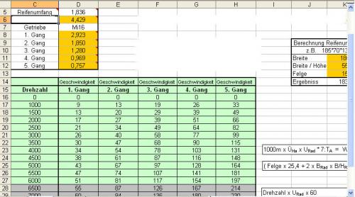

C_W
Yea, an Mi16 is totally unsuited to even a standard turbo. A 1.9 final driver on an Mi16 gearbox will give you very long gearing, 20% longer overall each gear??

Bam
hmmm...
not sure...have calculated something...
stock mi16 box....
mi16box with gti 1.9 final...
i'm right?!
cheers
mik
