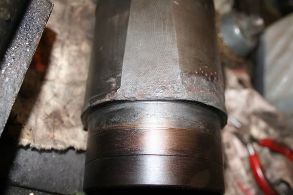

DamirGTI 362 Posted January 17, 2007 (edited) Hi! I have found one badly rusted liner today when i dismantle my engine block : http://i27.photobucket.com/albums/c151/Pie.../Picture075.jpg http://i27.photobucket.com/albums/c151/Pie.../Picture076.jpg is this dangerous ? will it seal properly on refitting or i have to buy another set ? thanks ! edit; image sizes, max 120k please. Edited January 17, 2007 by pugtorque Share this post Link to post Share on other sites
ALEX 103 1 Cars Posted January 18, 2007 (edited) You could check by fiting the liners and seals clamping them down using lenghts of 15mm copper tube and washers with the head bolts. Fill the block with water and check for leaks underneath. The (edit:- NEW) seals can be reused as they're only rubber. My girfriends 106 had a rusty liner like that at the bottom seal and when I put it together I checked if it was leaking, It was but only about a drip a minute. I used radweld to make a seal as sedement would soon seal it anyway. Seemed to work. I didn't get any mayo oil. Edited January 18, 2007 by ALEX Share this post Link to post Share on other sites
welshpug 1,735 Posted January 18, 2007 as long as the sealing surface and bore is good it'll be fine, use new seals as they're only a few pennies, not worth the risk. Share this post Link to post Share on other sites
Anthony 1,003 Posted January 18, 2007 The seals can be reused as they're only rubber. Do not reuse liner seals, as there is a good chance they won't reseal properly (hence all the dire warnings about not disturbing the liners when removing the head) and then it's a major pain in the a**e when you find it leaks and you've built the engine and it's installed in the car. That liner really doesn't look too clever and looks from the picture like the sealing surface has been badly eaten into - what does the surface on the block look like, as I've seen them corroded as well now... Share this post Link to post Share on other sites
ALEX 103 1 Cars Posted January 18, 2007 (edited) as long as the sealing surface and bore is good it'll be fine, use new seals as they're only a few pennies, not worth the risk. Do not reuse liner seals, as there is a good chance they won't reseal properly (hence all the dire warnings about not disturbing the liners when removing the head) and then it's a major pain in the a**e when you find it leaks and you've built the engine and it's installed in the car. That liner really doesn't look too clever and looks from the picture like the sealing surface has been badly eaten into - what does the surface on the block look like, as I've seen them corroded as well now... I ment reuse the new seals after doing the test I mentioned. Edited January 18, 2007 by ALEX Share this post Link to post Share on other sites
DamirGTI 362 Posted January 18, 2007 hi ! the reason i do this job is because i have broken my head bolt deep inside a block ant can't get it out ... so i scrap the block and use another one and fit everithing from this old block to that spear one.. all parts on refitinl will be new bearings , piston rings , gaskets and of course liner seals pics : http://i27.photobucket.com/albums/c151/Pie.../Picture088.jpg http://i27.photobucket.com/albums/c151/Pie.../Picture068.jpg this is old block .. that rusty liner is from 1-st cylinder = pic 088 oh and one more thing - must i get crakshaft machined when i fit it from this to another block ? some pics of big end bearings : http://i27.photobucket.com/albums/c151/Pie.../Picture084.jpg http://i27.photobucket.com/albums/c151/Pie.../Picture082.jpg cheers Share this post Link to post Share on other sites
lagonda 42 Posted January 18, 2007 Have just done similar job on my car, fortunately my liners were hardly corroded at all in that area. Looks like yours has been run without antifreeze, or a poor quality one with little anticorrosion content. I had to replace one of my liners as I'd left it too long after gasket failure, & water remaining in the bores had rusted the surface of one enough to mean blow-by under compression. The new liner was about £30, that was from Matt at QEP, so if cash isn't too tight, new liners aren't that expensive, although mail costs may be excessive due to their weight. Obviously you also benefit from unworn bores. On the other hand, looking at your photos, I'd say there is a fair chance water would leak past one of your liners, if not both, even with new liner "O" rings. That said there's no reason why a light coat of silicon sealant couldn't be used, it's hardly a tough environment and pressure in the water system is relatively low. One thing you would need to be careful of is not to use too much. Any excess that became detached could block tubes in the radiator, which wouldn't be helpful! Share this post Link to post Share on other sites

DamirGTI 362 Posted January 18, 2007 so it's ok to put silicon araund that liner "O" ring ? what kind of silicon any brand high temp. resistent or something special ? im litle short budget on this so my plane is just to do bearings , gaskets and piston rings because i was first wanted just to fit another reconditioned head but that job ended with one head bolt broken (very badly rusted and broken deep inside the block whit no possible way to get him out ... ) and removed engine out of a car and stripped Share this post Link to post Share on other sites

PumaRacing 2 Posted January 19, 2007 Hi! I have found one badly rusted liner today when i dismantle my engine block : http://i27.photobucket.com/albums/c151/Pie.../Picture075.jpg http://i27.photobucket.com/albums/c151/Pie.../Picture076.jpg is this dangerous ? will it seal properly on refitting or i have to buy another set ? thanks ! edit; image sizes, max 120k please. That's not unusual corrosion. What I do with those is put the liner in the lathe and polish the corner of the flange with abrasive paper to remove any high spots. The rubber sealing ring will seal ok. You can put a smear of silicon sealant on too if you like. Share this post Link to post Share on other sites
DamirGTI 362 Posted January 19, 2007 I will cross my fingers and give it a try too do as you say hope it will be good just with a new "o"ring and sealent around ... allthou this liner looks very bad too me ... thanks man ! cheers Share this post Link to post Share on other sites
