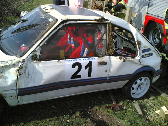

Everything about them is wrong. They dont fit the pillars well, poor welding, poor material and the brackets that attatch the door bars in are very weak. Ok they may be easy to fit but you can get safety devices, rollcentre, custom cages for reasonable money and they will properly fit the car and do a far better job. I have fitted one omp cage in gravel rally car before and the shell fell to pieces compared with a car with a propper cage. The rear beam mounting they use is also very weak. I am talking from experiance on this.
well when i rolled my 205 the OMP cage did well and s :wub: topped the roof touching my head and i did a few rolls and a few flips
Edited by hodgy
Guest SeanGTI
f***in hell mate. how did the car roll!!! you were lucky. no roll bar and it would of been bye bye head!!!
