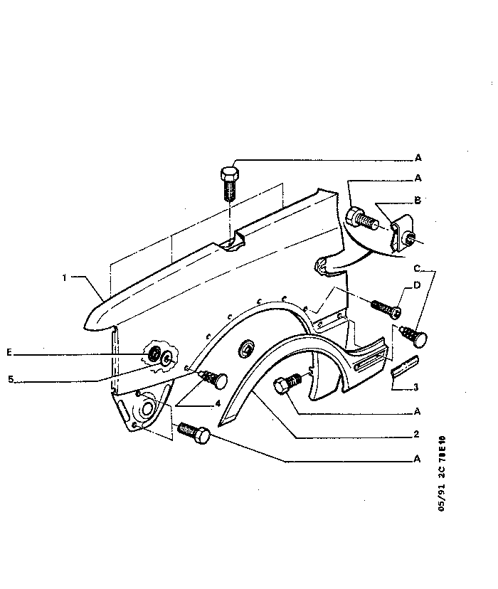

Edp 67 3 Cars Posted December 10, 2006 04 8565 14 10 MOULDING CLIP 05 8565 15 10 SEAL WASHER DIAM 5 9A 6993 81 01 SCREW BAG 6X100-16 9B 6943 23 01 SPEED NUT 6X100-22,5-15,5 9C 6992 34 01 CLIP 9D 6992 31 01 13,5X10-7,2 9E 6992 98 01 CRANK CLIP 6X21 Hope that helps. Share this post Link to post Share on other sites
welshpug 1,619 Posted December 10, 2006 there are two types, one used on earlier cars that is like a serrated plug, which IIRC fits into the wings that have the inserts, and the other type that has a plain shaft like in the pictures above, oddly enough I couldnt find it on Miamistu's parts catalouge but they are available from peugeot at a much lower Price than elsewhere take an old one in with you, and if all else fails try another dealer! Share this post Link to post Share on other sites
axnutty 10 Posted December 11, 2006 (edited) Cheers everyone - went down Peugeot again today armed with the above printout. (Caused a few questions of "where did you get that?") A large amount of pointing and scratching of heads later and it appears Ive ordered myself the correct bits. Shall find out tomorrow when they turn up! Just out of interest and to anyone in the same dilema just buy the whole lot of bidykits from Autofive at £30. Not only is not that more expensive to just buy everything, but your guarenteed to get all the bits you need. Eh well lesson learned I guess. Edited December 11, 2006 by axnutty Share this post Link to post Share on other sites

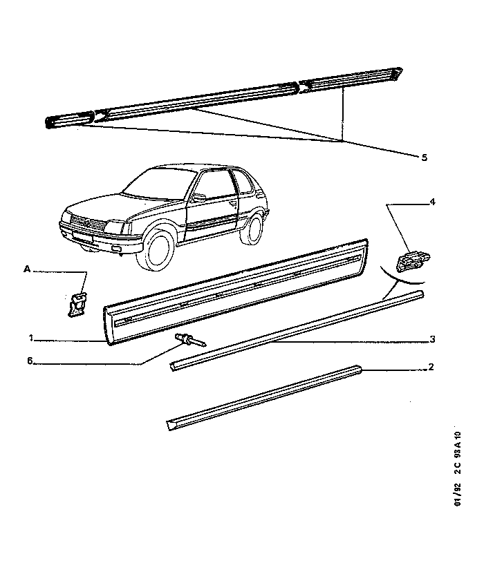

de Noir 0 Posted December 15, 2006 (edited) AFAIK, metal clips that fit these rivets (itam A on the pic) are the real issue. I tried to get them for my restoration project, but aren't available any more from Peugeot. So I ordered the bodyshop to remove them and smooth the surface and door protector will be fixed with 3M double-sided mounting tape. Edited December 15, 2006 by MH_ Share this post Link to post Share on other sites
welshpug 1,619 Posted December 15, 2006 i have a few hundred of item A and 4 picked up 2 carrier bags full of 205 and 309 associated bits when a parts guy mentioned he'd been sent to another dealership that was closing down to sort all the parts and keep the old obsolete stuff for himself. I've been meaning to sort through all this for ages! Share this post Link to post Share on other sites
