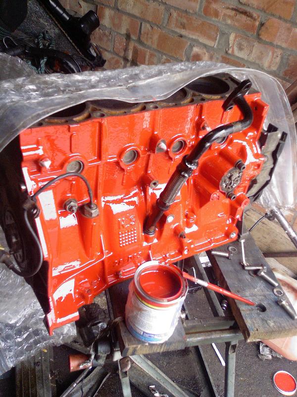

jacobs53 0 Posted December 9, 2006 Hi, Im rebuilding an EW engine next week and wondered what type of paint people use??? I have seen the VHT silver paint in a spray and brush on form... But not sure which would be better? And how well prepared does the engine block need to be, to enable the paint to adhere correctly? Cheers lee Share this post Link to post Share on other sites
welshpug 1,735 Posted December 9, 2006 paint is much better, spraying is rather expensive! ideally the block needs to be steam cleaned but a good scrubbing with gunk and a wipedown in a warm kitchen is good enough, I bought my last tin from motorworld when I rebuilt my sister diesel Ibiza, and 3 yars on it still looks good and its actually helped it stay clean you cant actually see much in the pic but the head is silver and the block blue, and everything is generally pretty clean and free of gunk Share this post Link to post Share on other sites

credowan 15 1 Cars Posted December 9, 2006 Looking great lads them engines look mint martin top wrk Gary Share this post Link to post Share on other sites
