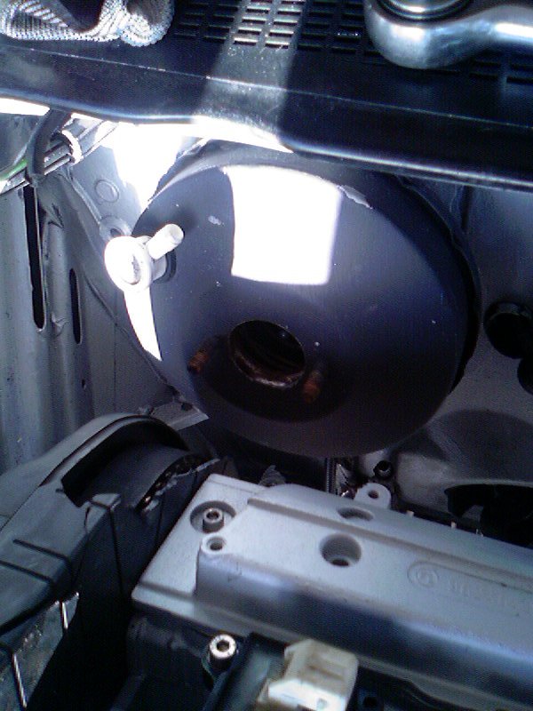

finaly got the gti6 engine in this morning ( after a panic about loosing the clutch plate bolts , and not being able to get that size anyhwere :excl: ), but there is no way in hell i am going to get the m/c back on .
even with the broken cambelt cover giving a little more space it looks as though it will hit the cam cover :)
i am running a solid bbm lower mount and std top mounts so there is no play in them , i read somehwhere that you can tilt the servo up with washers to give better clearance, either that or drop the engine slightly (not really sure how )
time for a bit of head scratching methinks
oh well at least its in yay!! :ph34r:

Try fitting the Mc anyway, you may well be surprised, but theres adjustments that can be made.

i have and cant even get it back on , just done a search not alot came up but there is a few things i can try .
i amy have to lowrr engine slightly then put it on then refit the engine as i think it will give more clearance when its fully fitted ,but i have a feeling it will still touch.
do you think it will be safe to remove the cambelt cover totally ? as it looks like it will catch there too

Removal of the cam belt cover has been a bit controversial in the past. There is the risk of picking up stones from the drivers side wheel and getting caught in the pulley wheel/cam belt. I know a bit of room can be made by elongating the holes in the gearbox mount mounting and sliding it as far to the drivers side as possible.
Without seeing pics of the sort of clearance issues you have, it's difficult to comment (as I've only done the Mi conversion, not the GTi-6).

Cambelt cover is never a problem! get the belt off and put a new one on, looks hurrendous all broken!
The only MC fouling issue is with the rocker cover, I always cut the far coil cover mounting lug off and there is loads of room. A little dressing is required too!

i was thinking of just taking the cover off and cutting the top section away and leaving the lower section to keep stray stoner from out of the pulleys .

My engine didn't have a cover fitted when I got it, but I wanted one on, but without removing the belt as it had just been fitted.
So I just cut the cover in half and slid it behind the pulleys. The way it bolts to the head/block means it wont come away, then the top cover holds it in place anyway, though this was on an Mi.
I'd get a new cover on it if it was me.

yeah its seems to be the same on mine si, the rear part bolts to the engine but mine is split anyway so i could quite easily remove it without taking the belt off , i am gonna try dropping the engine and tilting the master cylinder a bit and then see what happens , if i can get away with fitting a new cover i will , if not i will do without .
gotta get a new master cylinder anyway as my one looks to be original ( meaning its a big pile of rust B) )

Read my previous pos, there no need for any MC mods.

i agree with maxi on this as their is none on mine
simon isnt the gti6 different from the mi16 interms of size??
im sure the gti6 is a deeper engine but hey i maybe wrong?

yeah i read it and will try it before i do anything else.
do you have to grind the cover or just the lug that holds the coil in place? , if the cover how much can you get away with?
