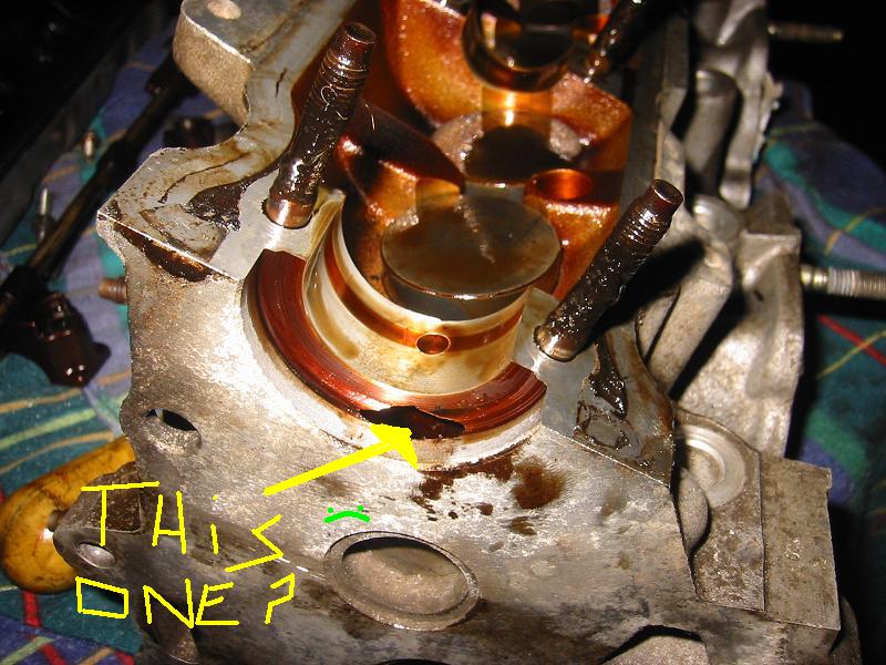

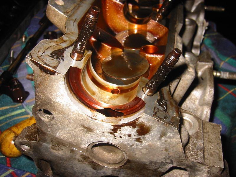

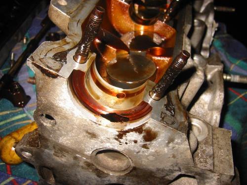

max0 5 Posted November 28, 2006 After taking my head to get refaced, they asked if I could remove the cam to make it easyer for them and cheaper for me. After taking the cam out I found this hole. Im guessing from looking at it, its not suppose to be there? (my dad woundered if it was a oil way but from looking at the shape of the hole im guessing not Is there anyway it could be repared or im looking at sourcing a new head? Share this post Link to post Share on other sites
boombang 2 Posted November 28, 2006 I think thats meant to be there - its the final oil drain where the seal goes. Share this post Link to post Share on other sites
max0 5 Posted November 28, 2006 I think thats meant to be there - its the final oil drain where the seal goes. From lookin at the shape of the hole are you sure? Share this post Link to post Share on other sites
Ahl 4 Posted November 28, 2006 Tis true, you'll find it on all of the engines. Share this post Link to post Share on other sites
max0 5 Posted November 28, 2006 Tis true, you'll find it on all of the engines. cheers guys thats just made my day! Share this post Link to post Share on other sites

max0 5 Posted November 30, 2006 will be replaceing seals and cam in my xm turbo within the next week or two prior to fitting... ill see if my oilways the same shape! cheers would be intresting to find out. Took the head to the machine shop today and they confirmed that it is a oil way - all be it a very od looking one. Its at the cam belt end by the way Share this post Link to post Share on other sites
pug309twin40s 1 Posted November 30, 2006 all the xu 8'vs cly heads have that hole at the timing belt end. not sure if diesel ones do iswell! always looks like a kid made the hole lol. Share this post Link to post Share on other sites
lagonda 41 Posted November 30, 2006 OK it looks amateurish but need to remember they're machining through to a rough side of the casting so it's never going to look pretty. Yes they could have fettled it to make it look better, but then why? Would only have added to the original cost. So long as it's there & it works is all that matters. Share this post Link to post Share on other sites
max0 5 Posted November 30, 2006 OK it looks amateurish but need to remember they're machining through to a rough side of the casting so it's never going to look pretty. Yes they could have fettled it to make it look better, but then why? Would only have added to the original cost. So long as it's there & it works is all that matters. The fact it looks amaterurish is what mad me wounder if it was supose to be there or not. It gave me a bit of a scare seeing it due to this been my first car engine rebuild Thanks to all who posted and put my mind at rest. Maybe they designed the hole late one friday night just before the electrics Share this post Link to post Share on other sites
