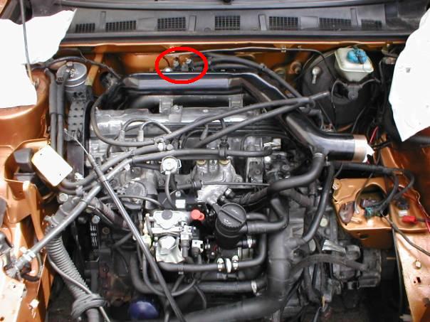

Bam
hi,
i mean that piece (red circle)
sonofsam
Yes so did I ~ Boost regulator solenoid.

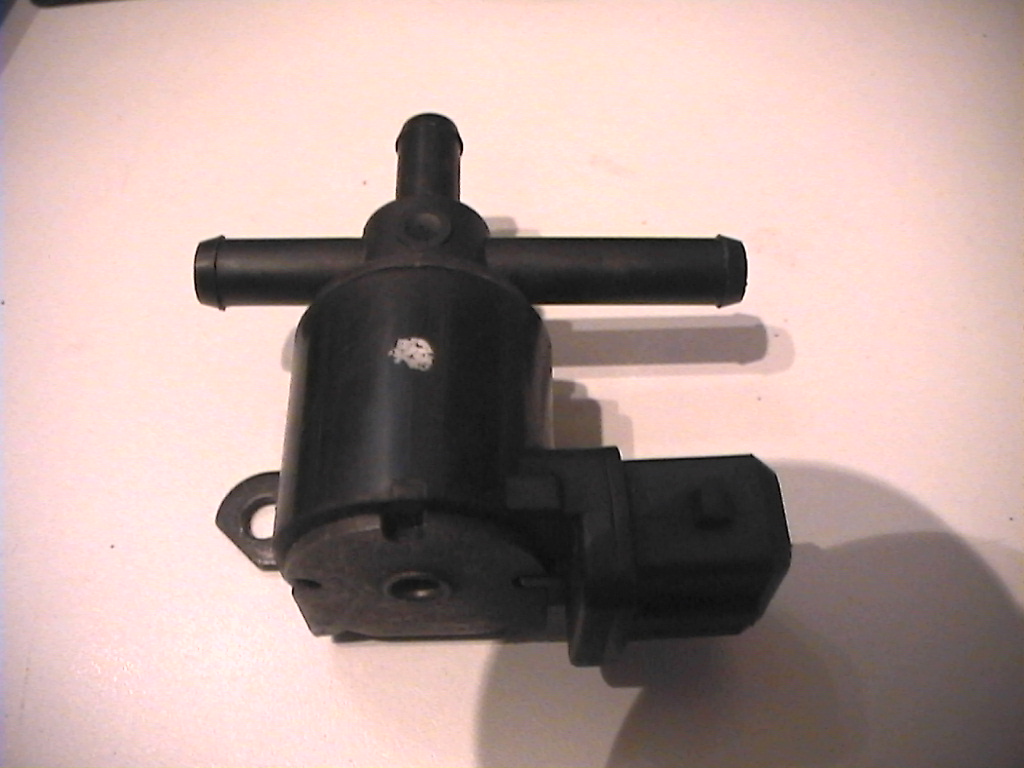

sonofsam
Yes thats what it is called :) and there not 100% reliable either!It has no connection to any 'boost pipes'
One side comes from the wastegate actuator, other side to air intake of turbo ( Black plastic pipe in shot )
Third exit on top ( I think ) usually goes to a canister? then onto throttle body wich is usually not used in this conversion.

Here is a nice up-close picture.If someone wishes to draw some arrows on it for future searches be my guest:D
Made by Eaton no less.

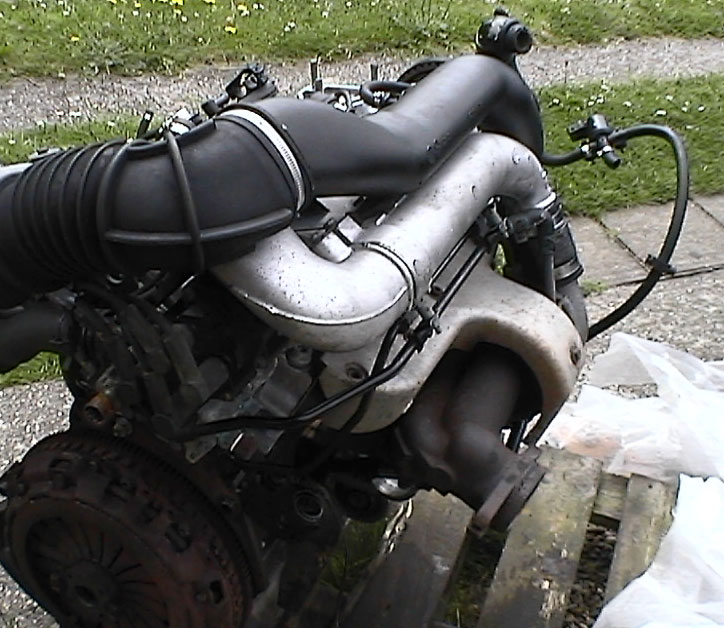

Well back to topic, and to confuse myself some more, just found this picture of when my engine was delivered:
I of course left the pipes attached as I found them for when refitting, and the valve was working, set up like that.. with the cut pipe blanked.
inferno
ive double checked mine from delivery, the diagram i added text to is correct for my engine. your engines an RGX though isnt it? slight differences in pipe work means maybe your one goes backward?!
eitherway the boost pressure pipe is missing in your picture, so you control wont be working as it wont be closing actuator with boost. AFAIK there solanoid switches, if your clever you can hard wire them to a switch and add a bleed valve for high and low boost!! sam can u run a low pressure airline through your solaniod and check flow of air in on and off conditions? in unplugged condition for safety, boost should flow to the air intake side allowing wastegate to open. in closed/active condition, boost should flow to actuator to hold it shut.
edit... if your boost circuits not makeing the actuator, and your still running high boost the actuator could be damaged/would out too long... iirc factory setup would b to open gate at 7psi, so run a 7psi arline to the actuator and adjust until correctly operating.
i normaly wind it and test it, screw measuring it ;)
Edited by inferno
