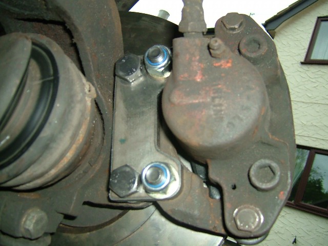

welshpug 1,737 Posted November 10, 2006 right, anyone got a piccie of these fitted? and also the dimensions? I want to make my own ones and i'm a bit confused as to how a plate can take the caliper out and hold it at the same offset, unless some spacers are used on the bolts, but as I said, some pics of a bracket fitted would be great. a quick calculation would lead me to think that the bolts are simply 17.5mm apart. heres what I want to replicate - Share this post Link to post Share on other sites

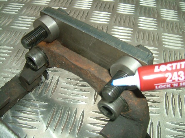

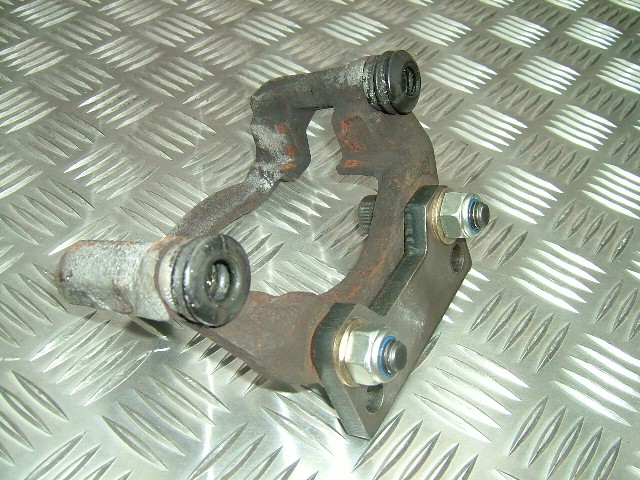

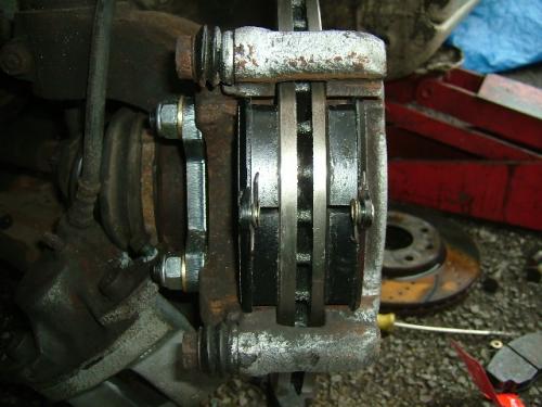

sonofsam 5 Posted November 10, 2006 (edited) I have these and they do use a GTI-6 Disk:) Could of measured them for you, however they are now on the car. Some of the Yoke need's to be ground down though.Nothing major to fit. Pictures are from the fitting guide that is supplied. Not really worth replicating IMO as the kit is cheap enough.Unless you know a cheap CNC milller or water jet cutter and can get hold of high tensile steel plate that is:D Edited November 11, 2006 by sonofsam Share this post Link to post Share on other sites

welshpug 1,737 Posted November 11, 2006 From previous post's I've read on the Autofive kit, it would seem the Disc's are the expensive part to replace? Were as GTI-6 disc's are relatively cheap compared:) AHA!!! just as I thought, thanks sonofsam for posting that pic, there are spacers on the bolts! I know that I can get the brackets for £30 and i've already got an ebay bargainous pair of gti6 discs (£22 ) I just wanted to see if it was possible to make up my own ones ( in know a few DnT teachers, and some machinists ) Share this post Link to post Share on other sites
