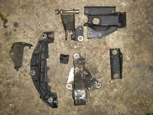

Paintguy 0 Posted October 29, 2006 Your post is so full of details, I hardly know where to start... I'm guessing by your sig, that you've got a 405 Mi16x4, and are transplanting the whole drivetrain into a 205. If so, you're going to need the x4 bottom mounting, as it's different to the FWD one, to make room for the transfer box. If you were just going FWD with the x4 block, then you can make a spacer up to bridge the gap between the (FWD) mounting and the block, where there would be a gap (see picture below), as this is what I'll have to do if I ever get around to it, as I also have the x4 version of the Mi lump. Share this post Link to post Share on other sites

Paintguy 0 Posted October 31, 2006 (edited) I understood what you meant the second time around, but was hoping someone else could be of more help I'll try and point Henry Yorke in the direction of this thread, as he was telling me just the other day about someone (his brother?) putting a front wheel drive block, into a 4x4 car. It happened to be the 309 Dimmax4, but it has the same drivetrain as the one you've got. If I remember rightly, the part of the 2WD block that corresponds with the mounting I've pictured needs grinding off to alow room for the transfer box and associated mounting, but I'll let him explain further. You'll definately need the 4x4 lower rear mount though. Edited October 31, 2006 by Paintguy Share this post Link to post Share on other sites

Higgy 0 Posted November 1, 2006 FWD engine in Mi16x4, but keeping x4 running gear. Correct? You just need to cut off / grind down one of the lugs on the block. Then use all the 4x4 engine mounts and transfer case mounts etc. You can see from the LINK on my previous post which lug it is. I had to tap the FWD block and use a spacer. You will have to remove the lug until it is roughly flush with the block. And as I said before. I should have ALL the 4x4 mounting brackets if you want them. Higgy. Share this post Link to post Share on other sites
Henry Yorke 269 3 Cars Posted November 8, 2006 Sorry, I only just remembers Paintguy had asked me to reply to this post! :$ Yes you do need to grind off the lug on the block to get it flush so the x4 mount fits. If you haven't got the mounts then I would have Higgy's As for the 309, it used everything from the 4bie; front subframe, engine, box and rear beam. Here is an as found underneath More pics here Share this post Link to post Share on other sites
