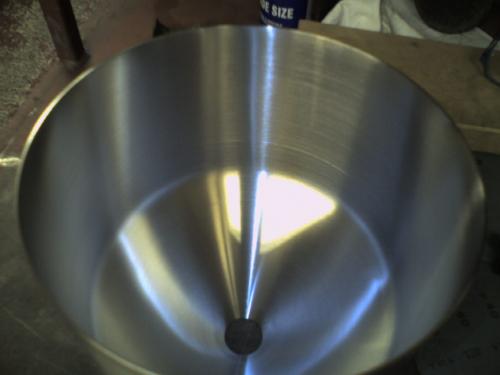

:wacko: Ok if we are bringin out the bling post-6977-1161104718_thumb.jpg This is what can be acheived with just plain emery cloth and scotchbrite. :excl:

Its not really bad just needs the shine bringing back.
