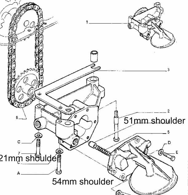

James_m 0 Posted October 9, 2006 Cheers miles, the S16 one went on fine which brings me to my next question regarding the oil pump See the cylinder type thing above the L shaped spacer, Does this exist? because i dont have one it goes into the block where a passageway leads to the oil filter. Also anyone know which size bolts are needed for the pump to block? all mine seem to long and i dont want to crack the block screwing them in further than they go. James. Share this post Link to post Share on other sites
mickie 3 Posted October 9, 2006 i never had that L chaped gasket on mine when i re-build my engine and are you sure you have the 3 oil pump bolts round the right way ? the 3 of them are all different sizes Share this post Link to post Share on other sites
pug_ham 242 3 Cars Posted October 9, 2006 A quick look on the parts cd suggests they are M7 & the two listed are; 7X100-85 7X100-75. They are the same on the XU10 8v so I'll try to see if I have saved mine in the correct locations tomorrow & if I have I'll post what goes where. Graham. Share this post Link to post Share on other sites
James_m 0 Posted October 10, 2006 Problem is, i have 6 - 3 from an S16 and 3 that came from the Mi16. Maybe i'll just use extra washers to make them fit.... Anyone know about the cylinder type washer above? does it exist? Share this post Link to post Share on other sites
pug_ham 242 3 Cars Posted October 10, 2006 Anyone know about the cylinder type washer above? does it exist? The picture is upside down, thats a locating dowel imo. The bolt lengths are as below in attached picture & roughly tie up with the lengths quoted above. Defunately M7 thread, same as sump bolts. Graham. Share this post Link to post Share on other sites
ALEX 98 1 Cars Posted October 10, 2006 The L shape spacer about 1/4inch thick IIRC (item 3) is for early models. Mine has one but it's a lot thinner. It's more of a thin metal gasket than a spacer (item3) other engines I've taken apart didn't have one at all. The Haynes book i have (Worksop Manual not operating and maintenance) says that you discard the spacer if the pump is replaced as all new pumps should be the new design. that doesn't need a spacer. Share this post Link to post Share on other sites
