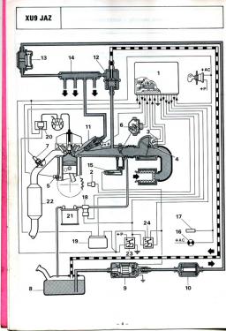

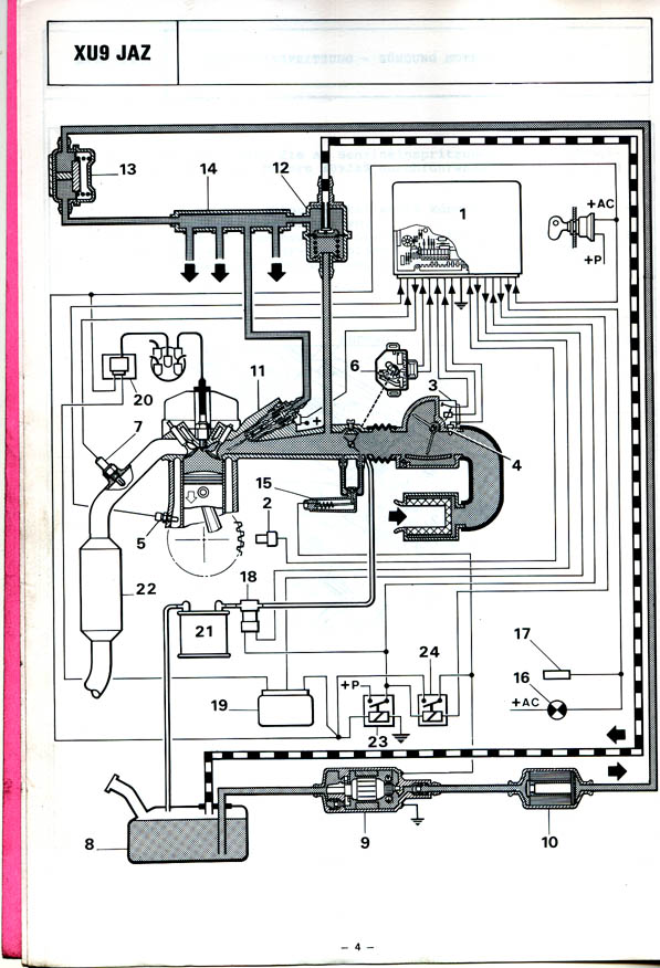

Emmy Seize 8 Posted September 28, 2006 Look out for the purge canister under the left front wing. If there is none, your car is unlikely to have a pcv. As has been said before, these systems are found on Motronic cars, not on Jetronic ones. Number 18 in the picture is the pcv. Share this post Link to post Share on other sites

Emmy Seize 8 Posted September 29, 2006 (edited) Jim is right, the valve I mentioned is not the one we are looking for. Crankcase ventilation on the XU engines happens (as far as i was able to find out) via the hoses that are attached to the oil filler. I checked cars with both systems (Jetronic and Motronic) and did not find any sort of valve in the lines. As Jim said, this is just an emission control measure, so using open breathers shouldn´t affect the engine running at any point as long as you block off the hoses leading to the inletmanifold properly. Edited September 29, 2006 by Emmy Seize Share this post Link to post Share on other sites
