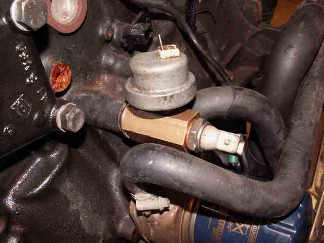

sonofsam 5 Posted September 25, 2006 Is this the kind of adaptor you mean Jonnie? I have one somewere to fit , got it from DemonTweeks. Share this post Link to post Share on other sites

pugpete1108 62 1 Cars Posted October 13, 2006 Is this the kind of adaptor you mean Jonnie? I have one somewere to fit , got it from DemonTweeks. is that an 8v sensor fitted in the top ? and why have you kept the gti6 sensor? Share this post Link to post Share on other sites
sonofsam 5 Posted October 13, 2006 is that an 8v sensor fitted in the top ? and why have you kept the gti6 sensor? Not my engine, but yes thats an 8v sensor in the adaptor on a 2.0L T.Not entirely sure the pressure part of the gauge works on that set-up.The other bit is for the light is it not? Share this post Link to post Share on other sites
mbayley77 0 Posted October 13, 2006 Yes the horizontal part is for the light. I dont see why this shouldnt work for the guage though??? Share this post Link to post Share on other sites
pugpete1108 62 1 Cars Posted October 14, 2006 Yes the horizontal part is for the light. I dont see why this shouldnt work for the guage though??? are you using this set up? Share this post Link to post Share on other sites
