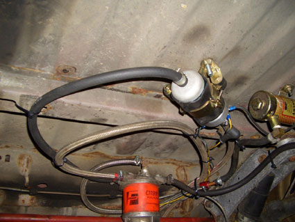

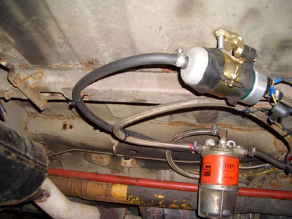

Jesus - you want to try taking pictures under a car, in the dark, when you can't see the viewfinder (and even if you could it would be black!)
Right then, here is my set up - needs tidying up a bit and needs a shield to protect it, but functions perfectly well. In fact it's pretty groovy - you go round a tight righthander and then you hear the pump frantically topping it up for a couple of seconds :)
Because I couldn't see what I was doing I don't have 1 piccie thats shows everything so look at both!
This pic 'almost' shows low and high pressure pumps!
this shows pot does dangle just proud of rear beam (height wise)
Hope this helps mate
