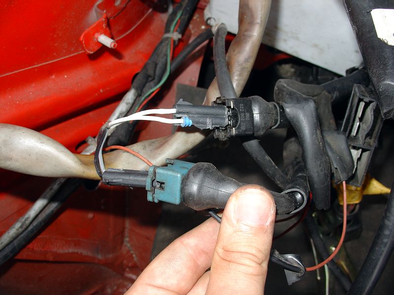

cybernck 403 1 Cars Posted August 8, 2006 hope this helps: (both whites to the black connector, grey and black to the blue connector). p.s. don't cut and/or solder the wiring as apparently lambda sensor won't function correctly. hilgert can tell you why more precisely . Share this post Link to post Share on other sites
