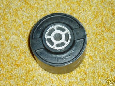

smckeown 1 Posted May 2, 2006 are yopu running with a solid bottom ? Share this post Link to post Share on other sites
Jonmurgie 2 Posted May 2, 2006 The first repair wasn't a crack, it's Sean's old manifold and it needed a fix where someone had tried to port-match it to a head, so as far as I know this is the first time it's cracked. It was wrapped in heat wrap... and to be fair it does an AMAZING job of keeping the heat out of the engine, you can hold your hand over the manifold right after coming off track! But there are downsides, it speeds up the corosion of the metal so a stainless manifold wrapped would be much better. I'm running a GrpN lower mount so don't feel it's cracked due to movement, more likely heat or something... it has been fine but seems to show signs of cracking not long after being mapped on the MoTeC... Will see what the exhaust guys say... Share this post Link to post Share on other sites
Malachy 0 Posted May 2, 2006 The first repair wasn't a crack, it's Sean's old manifold and it needed a fix where someone had tried to port-match it to a head, so as far as I know this is the first time it's cracked. It was wrapped in heat wrap... and to be fair it does an AMAZING job of keeping the heat out of the engine, you can hold your hand over the manifold right after coming off track! But there are downsides, it speeds up the corosion of the metal so a stainless manifold wrapped would be much better. I'm running a GrpN lower mount so don't feel it's cracked due to movement, more likely heat or something... it has been fine but seems to show signs of cracking not long after being mapped on the MoTeC... Will see what the exhaust guys say... looks like a poor weld in first place, has not penetrated and therefore cracked Share this post Link to post Share on other sites
smckeown 1 Posted May 2, 2006 (edited) The first repair wasn't a crack, it's Sean's old manifold and it needed a fix where someone had tried to port-match it to a head, so as far as I know this is the first time it's cracked. Yeah never suffered a crack or needed repair while I owned it. As you know PumaRacing had a go at matching, realise he was going to run out of material and stopped. BAsed on the receipts I had from the previous owner, I would say the manifold is 5 years old. I'm running a GrpN lower mount I'd still look at a solid mount, especially the abuse you give a car. You want to try and prolong the life of a manifold Edited May 2, 2006 by smckeown Share this post Link to post Share on other sites

pug_ham 242 3 Cars Posted May 3, 2006 I'm running a GrpN lower mount so don't feel it's cracked due to movement I'd still look at a solid mount, especially the abuse you give a car. You want to try and prolong the life of a manifoldA groupN mount is pretty damn solid, there are no spaces around it to allow movement. For all the difference a solid alloy one would give I'd stick with the group N mount. Graham. Share this post Link to post Share on other sites
