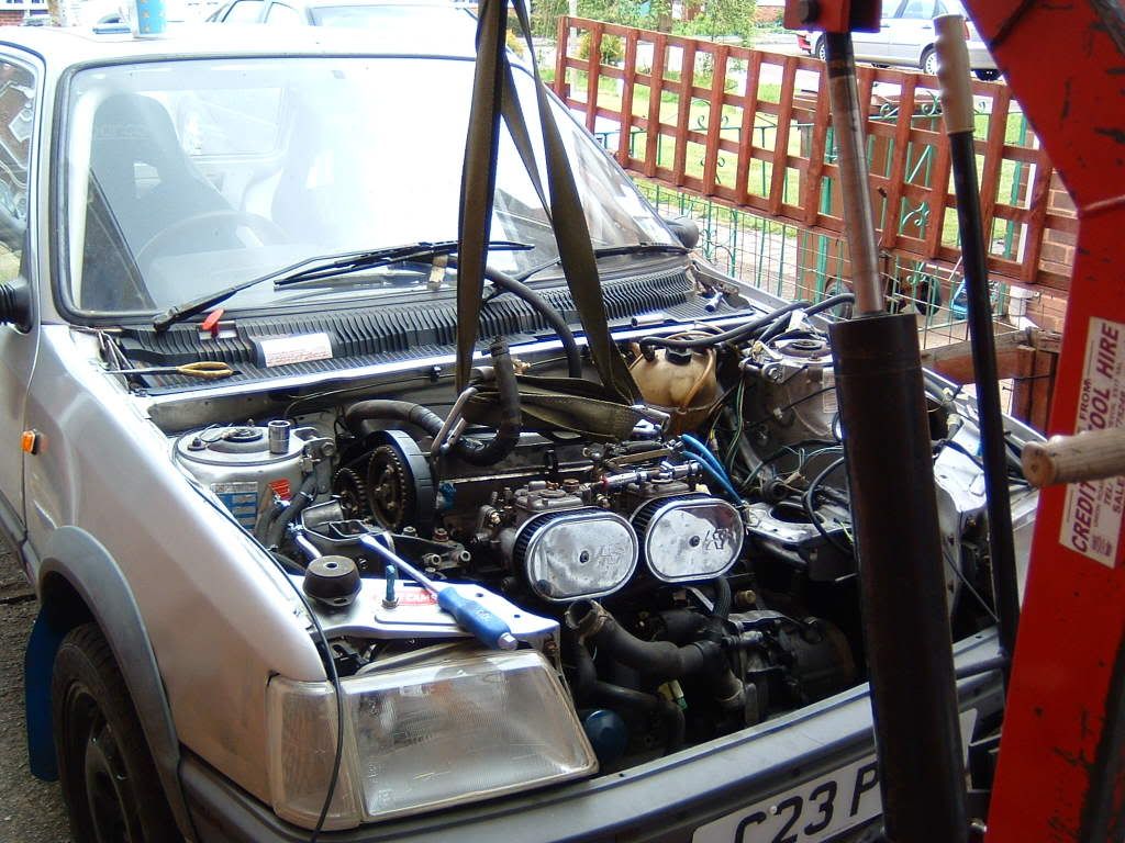

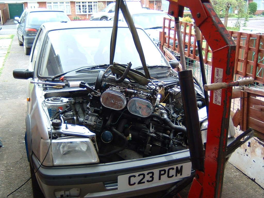

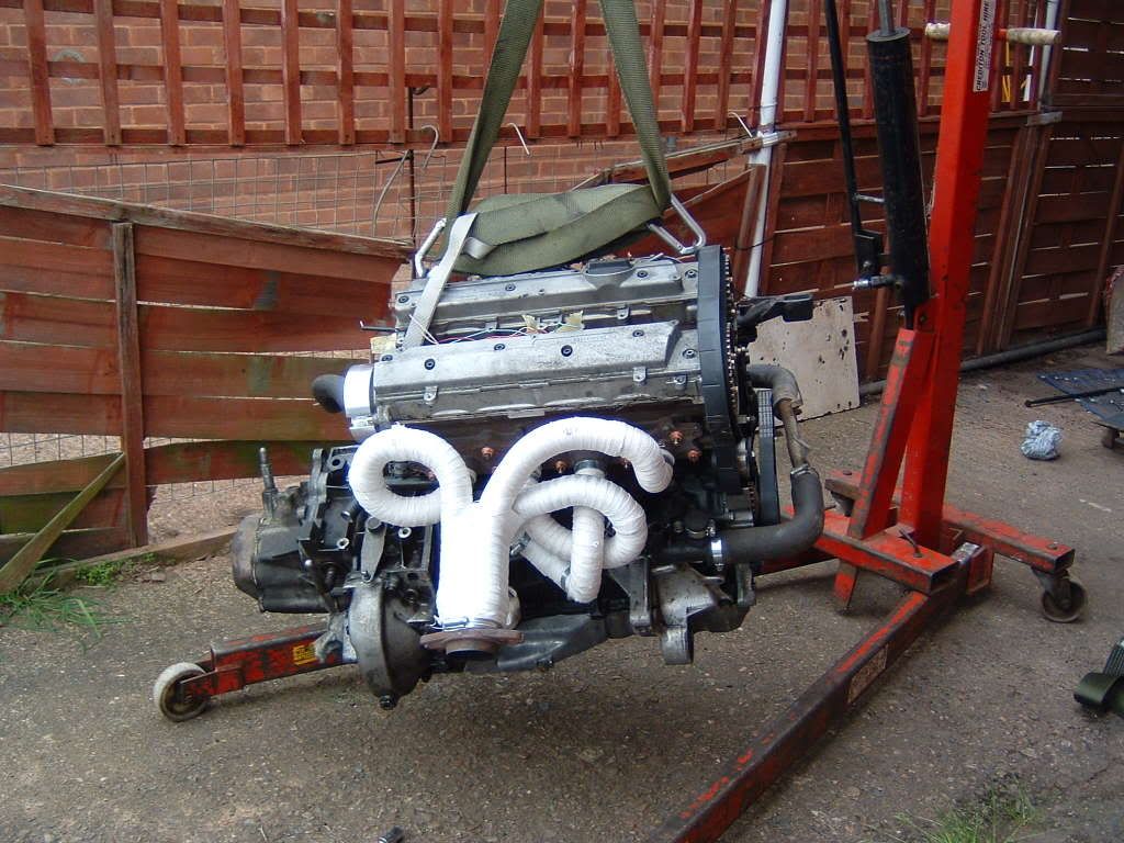

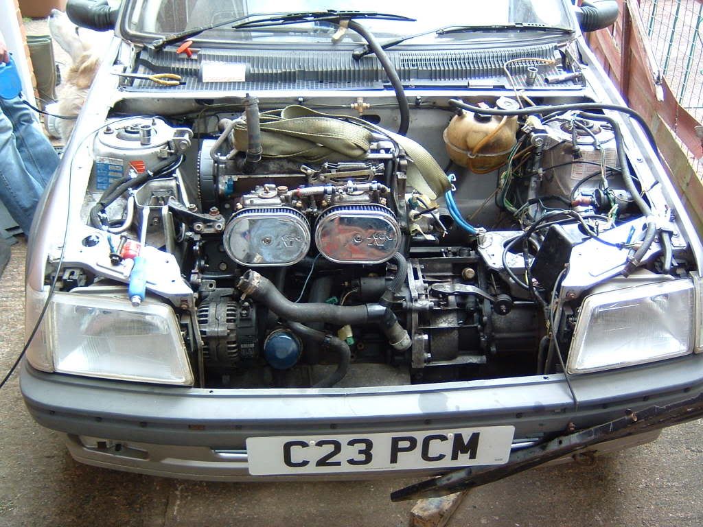

mbayley77 0 Posted May 16, 2006 Wanted to do a quick update on getting my 306 engine into the 205 this weekend. i was well surprised with quite how well and really how easy it was to get into the car. It was tight but with slow careful movements it went in without any problems at all. i have opted to keep my twin 45's on the engine for now with the aim in the future to get a nice big lairy cam to open up the breathing a bit. I have wrapped the exhaust to try and keep under bonnet temps down. And my money saving design of using a dizzy from the exhaust cam. I couldnt get any info even though i know it has been done before. I did find somewhere that shall remain unamed but thought £150 notes was way to expensive for something that i thought (and now know) could be done with a bit of thinking and a lot less cash. My distributor drive uses the drive from the vacuum pump which has been machined to slightly different dimensions and a spacer of aluminium. The dizzy then bolts to this. Works a treat. Cant wait to fire her up properly. Me and my dad turned her over tonight but with no downpipe on it the noise and flames from the downpipe were a bit much for the neighbours dizzy drive Exhaust Wrap tight? tighter? ive got my doubts! how? holding your own Share this post Link to post Share on other sites

Wurzel 16 Posted May 24, 2006 Nice looking set up. I reckon you might want to change the air filters on your carbs though before getting it all properly tuned up. I'm sure you will be able to get more bhp/torque from using a better designed filter. No experience here, just remember reading some article in the 'old style' CCC magazine many years ago. Carbs is something I'd like to have a go with in the future. Share this post Link to post Share on other sites

Edp 67 3 Cars Posted May 29, 2006 Havent noticed this thread, man those carbs sound superb! did you have to modify that exhaust manifold at all to fit?? Keep up the good work!! Share this post Link to post Share on other sites
Sam 4 Posted May 29, 2006 Have you had it all setup yet? That'll be the killer, finding somewhere skilled with carbs. Took me ages and it never seemed to be "right". Tb's sound similar, but there is a difference. tbs. Share this post Link to post Share on other sites
mbayley77 0 Posted May 29, 2006 Cheers for the support in this thread As far as the manifold was concerned I didnt have it modified, but I did do some reshaping on the bulkhead. not a lot, just the bulkhead to floorpan seam. Seems to be fine. Awsome sound in that vid. I would love TB's but havnt got the money right now. Where you too in the south? Took mine out for the first time today. Absolutely brilliant. Loved the sound of the carbs on the new engine. Seems to run a little rough but am gonna book her in hopefully at the end of this week or beginning of next week for tuning. Then got haynes track booked up for the 10th june so gotta put some miles on her and get her run in. Oh and driving it today with the LSD fitted was awsome. Everybody needs one of these. Share this post Link to post Share on other sites
