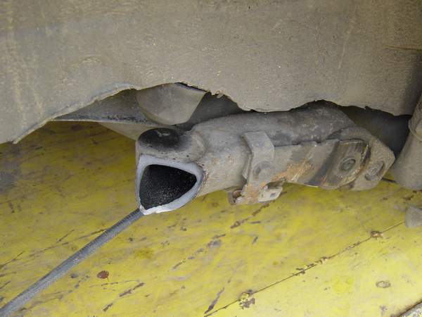

I'm not talking about impacts, i'm considering the lateral loading on the wheel transferring to the arm and bending it (or twisting it?), in relation to the horizontal moment the arm would transfer ultimately to the tube by way of that triangulation arrangement. The torsion bars aren't only twisting, they're bending as well because they're significantly offset from the rotational axis of the arms. And in such a situation will only offer a nominal resistance on the horizontal plane, as they're already distorted. The ARB can't offer any meaningful resistance to horizontal bending of the crosstube at all.
Now, if you are talking about twisting the tube... I do not need even to explain it, thousands of kilometers of rally stages have failed to bend/twist the tubes with cut outs like these, so theres your proof :lol:

When I'm talking about bending or twisting of the arms or tube, i'm referring to deflection under load which isn't permanent, but momentry and leads to variations in the geometry at the wheels. Due to the natural "spring" in the steel/iron.
Rippthrough
I've sold the car and the engine now.
Which makes the mods just as bad as the original :)
