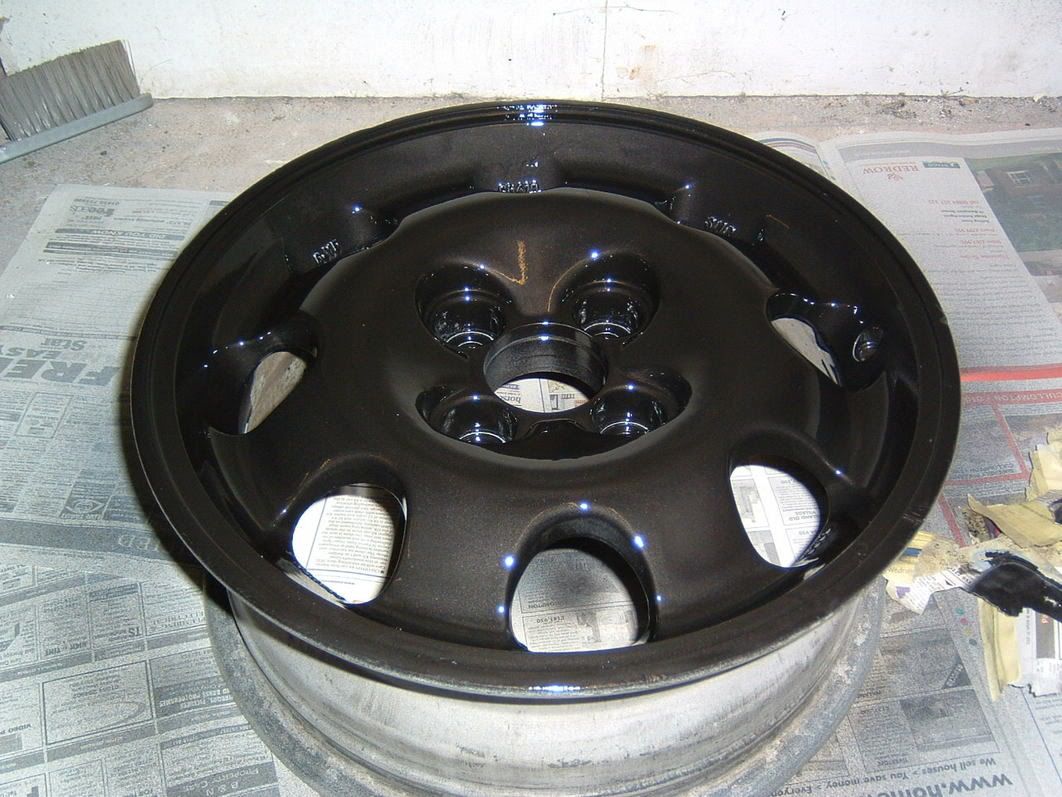

I have done mine by hand. Things i done were....
1. rub down wheel with wet and dry / scothbrite / brillo pad wrapped around a drill bit for getting in those roundy places & a file for getting rid of those nastie kerb marks on the edge of the rim.
2. Make sure its ultra clean and also is ultra dry - i leave mine near a radiator over night which makes em nice and warm for when you spray them too :D
3. I used etch primer (recommended to me by a spraying company for alloys) a coat applied well shouldnt need rubbing down although any runs or rough areas may need a light rub with some fine wet and dry. (600 grit or so)
4. I used dark grey for my paint and found a single coat or at most 2 coats covered the wheel fine but your white may need more! (hence one large can of paint covered 3 wheels)
5. Finished off with 4 coats of clear lacquer. This equates to a complete can of lacquer per wheel. but brings up a lovely finish.
As for cost the etch primer is expensive at about 15 quid a large can.
paint was 3 quid a can and lacquer was the same.
not sure if your white paint would need lacquer but may well be worth getting one which does as lacquer is a harder substance than paint itself so will not stone chip so bad.
