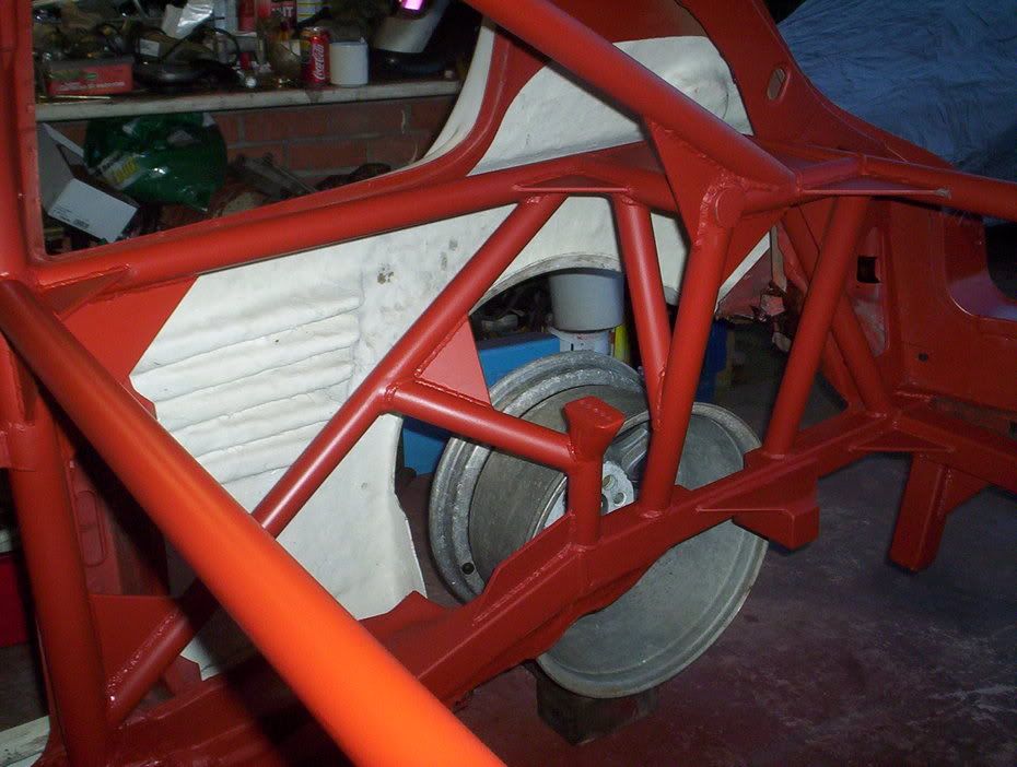

Martin@PRD 0 Posted February 28, 2006 Well as most of you know by now, Im planning to fit a radiator in each of the rear arches to cool the v6 sat in the back of my 205. I have been looking for dimensions of various radiators up for the job, which may turn out to be a bike type one, but struggling to find dimensions and unfortunately I dont have time out of the workshop to go down the scrappy at the moment, can anyone help? The maximum size I can fit is, Height. 22 inches/560 mm Width. 15 inches/380 mm Depth. Approx. 4 inches/108mm (Though please bear in mind I do have to fit a fan) Does any one have a radiator kicking about a round this size they could measure for me? Im sure a mini radiator might fit http://img.photobucket.com/albums/v728/tomoprd/100_6943.jpg http://img.photobucket.com/albums/v728/tomoprd/100_6887.jpg http://img.photobucket.com/albums/v728/tomoprd/100_6952.jpg http://img.photobucket.com/albums/v728/tomoprd/100_6951.jpg Thanks Share this post Link to post Share on other sites

Martin@PRD 0 Posted March 1, 2006 There are a few options 1. Rad for each wing 2. Rad part of the boot lid (vacuum effect) 3. Rad in roof 4. Double rad in the front The reason Im wanting them in the arches is simple direct the flow though the engine compartment extracting the heat given out by the exhaust out the back. Placement of rad in the roof, I would of thought to be to high for the flow of coolant unless a secondary electric pump was installed, fitting rad in boot would mean cutting a great big hole and blocking driver view as well being as it being to close to the exhaust which has limited space already. There is certainly not enough space for a second rad in the front so thats out of the question. As for cooling efficacy for engine this not going to be any use as the rad isnt facing on coming air, fans and a special coolant will hopefully help level temps, if not I will have to use co or Nos like they do on intercoolers but as for sprints I wont have a problem Share this post Link to post Share on other sites
