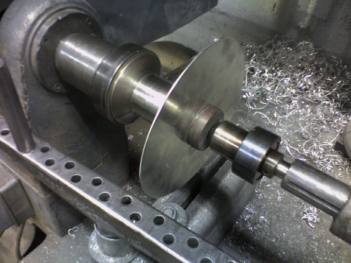

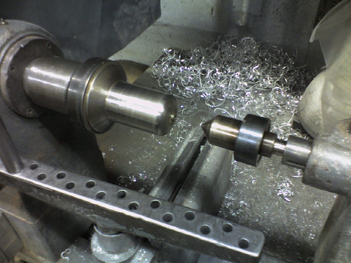

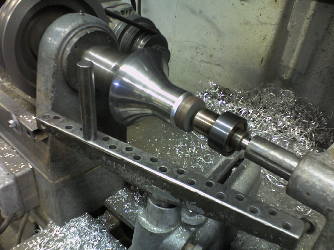

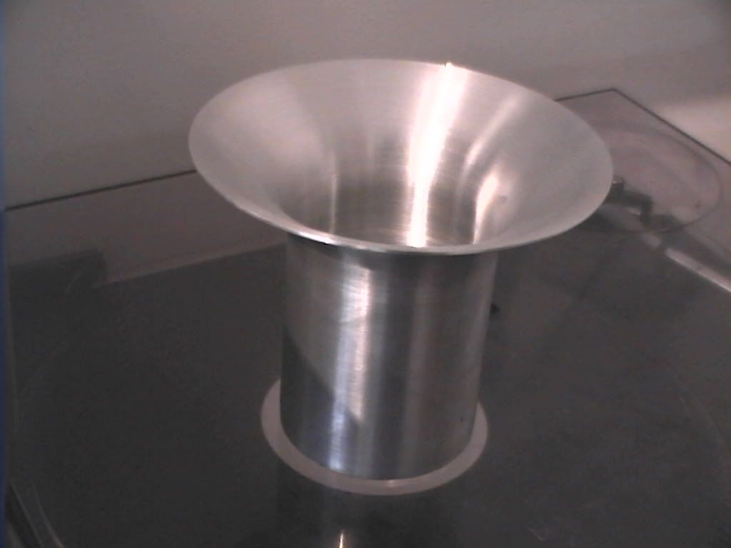

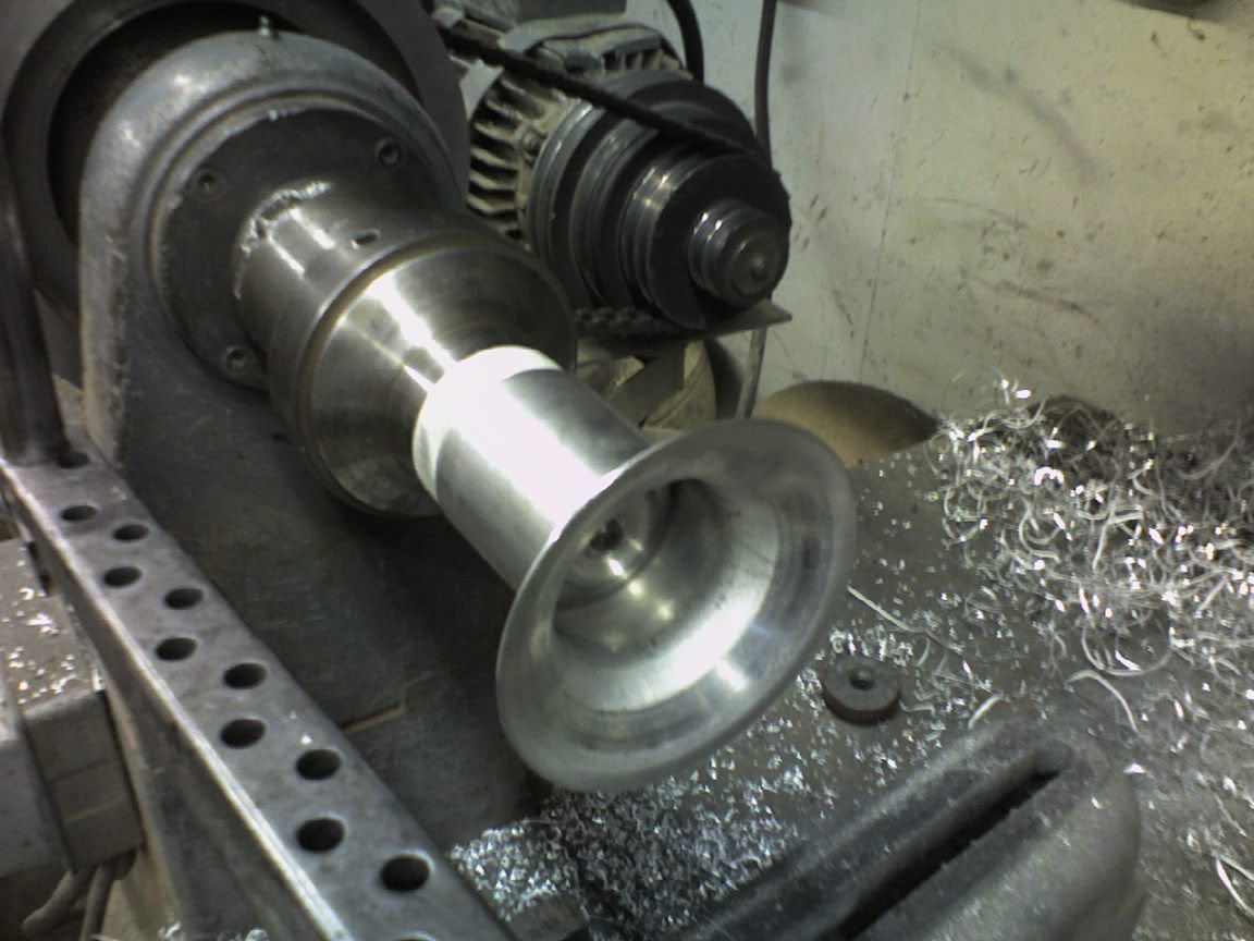

Edd here is the solution to your problem,will drop you an e-mail later to discuss the finer points ;)
Cold air feed
Sam.
PS.No Thumbs were hurt in the making of this spinning :o

:D Dont see why not,Have to admit i got Keith to make those Intakes today as he's been spinning for 12 years or so,my polishing work though
My Boss was confirmed out all day ;) ,so spent a good hour and half making 4 of the above,thats were the problem lies am more than happy to do it..just may take a while,and the fact that i have to blatantly/sneeky walk of the premise's with.....we have camera's

sonofsam - can you do virtually any size trumpets? I quite like the look of those (although I think I'd prefer the angle change to be more gradual if possible?)

Well yes any height,diameter and wall thickness ca be obtained with the right Tooling .but no if we dont have the size's you want avaialble a steel chuck will have to be made.Alternately a wooden section tool can be made up rather cheaply but you compramise the overall finish of the trumpet really doing it that way.
Yes the angle change or as we call it the radius can be what ever you want,The Metal is easier to come by as i used centres already trepanned out from another job.
Most shapes can be made from the first Drafting Spin It down ,cut the Front of,and then put in on Backwards to polish.
Hey presto..a good spinner could easily knock out 60 - 70 of them a day
