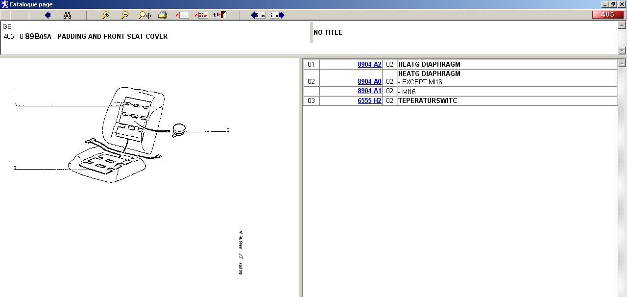

Frequentflyer
Here's the diagram showing the thermostat on a 405
http://i7.photobucket.com/albums/y291/supe...heatedseats.jpg
