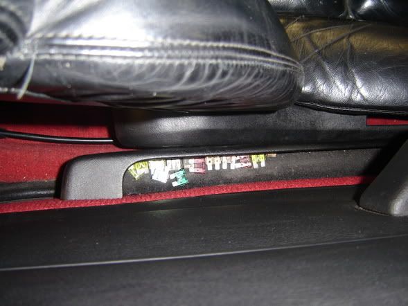

I finally got around to finish fitting my new seats. They're a tight fit but they do fit, the electric recline works as well. I had to bend the handle out of the way so it didn't foul the motor but apart from that they went straight in.
a tight fit!
the switch i robbed from my orion
a tight fit!

Congrats - and a motorised back rest! Not bad!

they weren't too bad to do really, it was just a bit time consuming with having to fabricate the switch holder. I think it was worth it though. :ph34r:

They look great. I got my 405 seats in yesterday, although i am not entirely happy with the lack quick access to the handbrake. (i play with it lots...)
Otherwise they look fantastic, and are far more comfortable in the 205 than my 405. (due to removing the back spacer they sit at a good angle)
