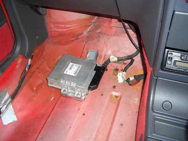

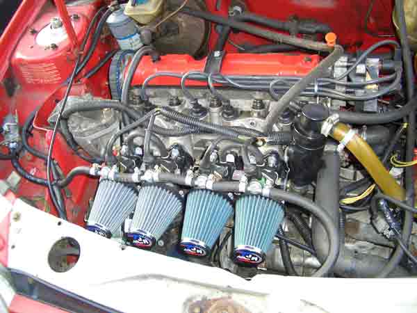

TT205 42 Posted December 19, 2005 OK got a couple of pics now This is where we have sited ECU in passenger footwell And this is the under bonnet shot! So Graham wasn't quite correct. I actually have Weber 45's (throttle bodies not carbs), turned out my Jenveys were downdrafts so had to get some more Road legal? - don't get you mate I hope it is, I was out in it yesterday Ahl - Only reason I would want another RR session other than to get a pretty graph would be if it needs some cold start mapping - at mo not sure whether it just needed a good blow out or if it does need this - will know next time I have a blast Pugrallye - how much? The noise is amazing - sorry - I think I already said that Share this post Link to post Share on other sites
