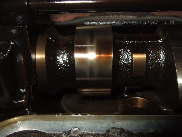

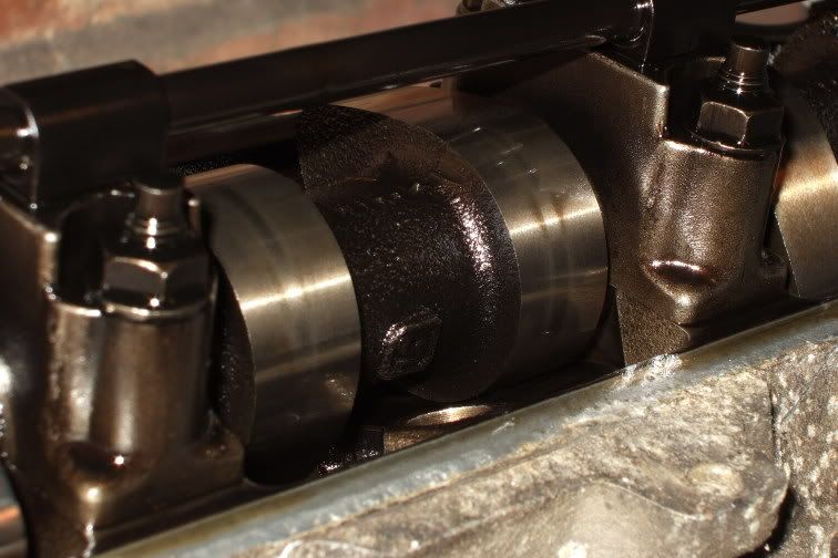

MartinR 0 Posted February 13, 2006 Here is an example of a fooked one... albeit a 1.6 cam Fooked Share this post Link to post Share on other sites
returnofjim 0 Posted February 13, 2006 Here is an example of a fooked one... albeit a 1.6 cam Fooked I have a 1.9 Cam thats worse than that, its almost round on one of the lobes That came out of a 90k mile engine which had full service history upto 80k Ill get a pic of it in a bit. Share this post Link to post Share on other sites
Guest downsy Posted February 13, 2006 (edited) Heres a 1.9 cam after about 98,000 miles http://i7.photobucket.com/albums/y275/pugk...06_02130073.jpg http://i7.photobucket.com/albums/y275/pugk...06_02130069.jpg Going to be replaced Mark Edited February 13, 2006 by downsy Share this post Link to post Share on other sites
