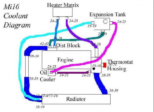

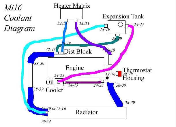

Guest Tronic Posted February 22, 2005 Hey guys one of the hoses going to the heater matrix has sprung a leak and the other one is probally going do the same shortly. As it never really gets cold enough to use the heater i was thinking of by-passing the matrix altogether and using one hose to replace the two currently beign used. My question is does anyone know if the hosing is the same diameter all the way along eg can the same size hose be connected at each end? Pug original parts aren't that easy to get where i am so i'm hoping to use some generic heater hosing. Cheers Troy Share this post Link to post Share on other sites
pug_ham 242 3 Cars Posted February 22, 2005 From looking at the diagram I have for the Mi16 coolnt hose diametres you should be OK with a piece of hose about 30mm diametre. See attached image, they are both about 28-29mm on the engine side. Graham. Share this post Link to post Share on other sites
