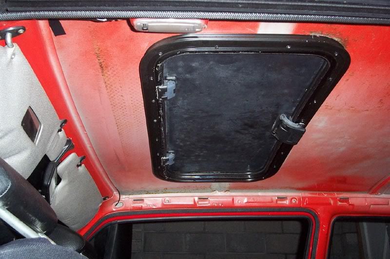

Guest fthaimike
what's peoples views on cages with aftermarket sunroofs still in the car?
as i have a non-pug car (mk1 golf) that im preping for track use but the damn thing has an aftermarket sunroof fitted at the moment.
it can be easilly removed as it comes in 2 pieces, top half that slides into the hole in roof & the bottom half that screws into the top half from inside but im stuck then with trying to fill the hole over?
Sunroof
shepherdfte
Interesting. I prepped my track/rally car from one with a aftermarket sun roof. Works fine, and I simply replaced the light alloy from back in the car, but simply glued a thin (ish) sheet of steel over the hole using aerospace glue. However, to stop it going 'flat', I did build a central brace in the middle. As I kept the air deflector etc, the car looks for all the world like it still has a sunroof, especially as I painted the steel black.
However! Note that the cage will only JUST go in with the frame bolted in, so I would plan to put the frame in later if I did it again (OMP 6point bolt-in).
In terms of the post subject, I would say it is fine as a road car (I use mine for both getting to work and national events). I basically kept all of the trim, carpet, etc, but got rid of all the heaavy underlay, and the rear seat metal etc. Cage definitely stiffens the car, and would certainly be benificial if I crashed on the road. Rear seats are a no-no with this cage, but I guess some will work.
Do you really want the rears? Getting in and out of the front is ok despite the door bars, but the back would be very hard because of the main hoop bolting to the seatbelt lugs etc.
On which note, the OMP cage prevents you fitting the normal seat belts, so the harnesses will also be a consideration for rear seat passengers.
