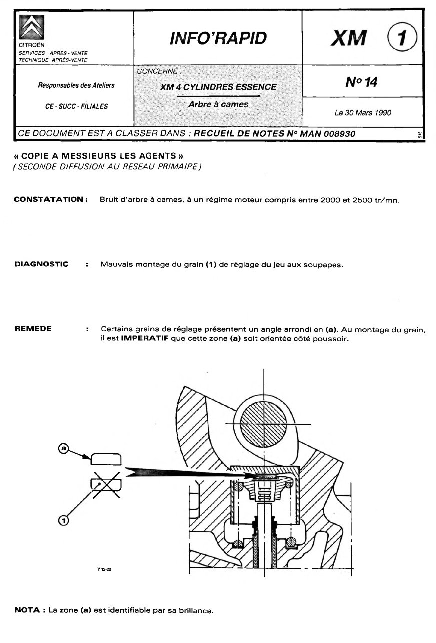

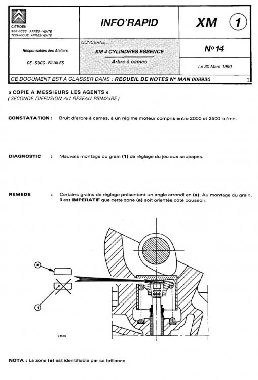

SRDT

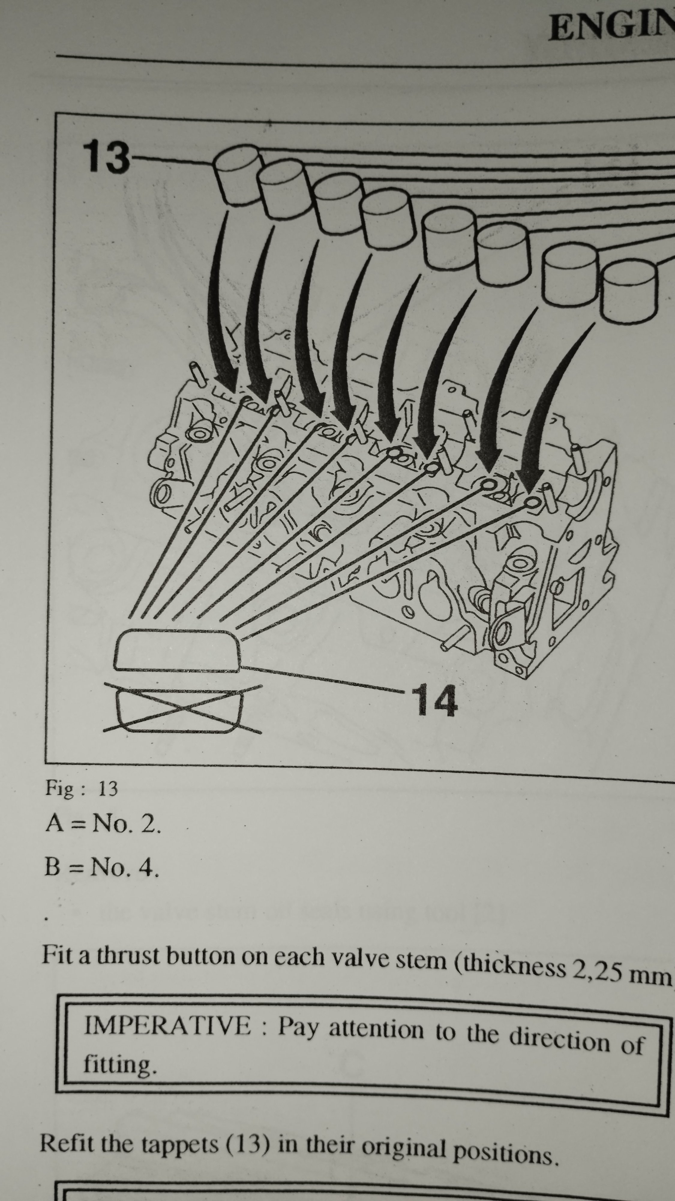

I couldn't find why some of them are rounded and others aren't but I did find what can happen if you put them the wrong way : cam noise around 2000-2500 rpm

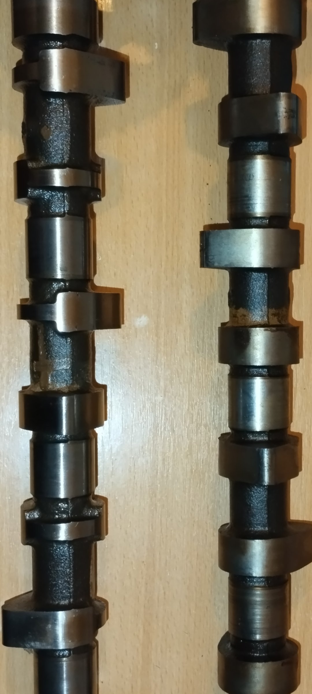

DamirGTI
They did some changes on the later cams as well .
Not sure if it's sometnihg to do with this , or simply production cost savings .
The back side opposite the cam lobe nose has less surface area on later cam compared to early .
'97 RGX cam on the left , '92 RGY on the right :
