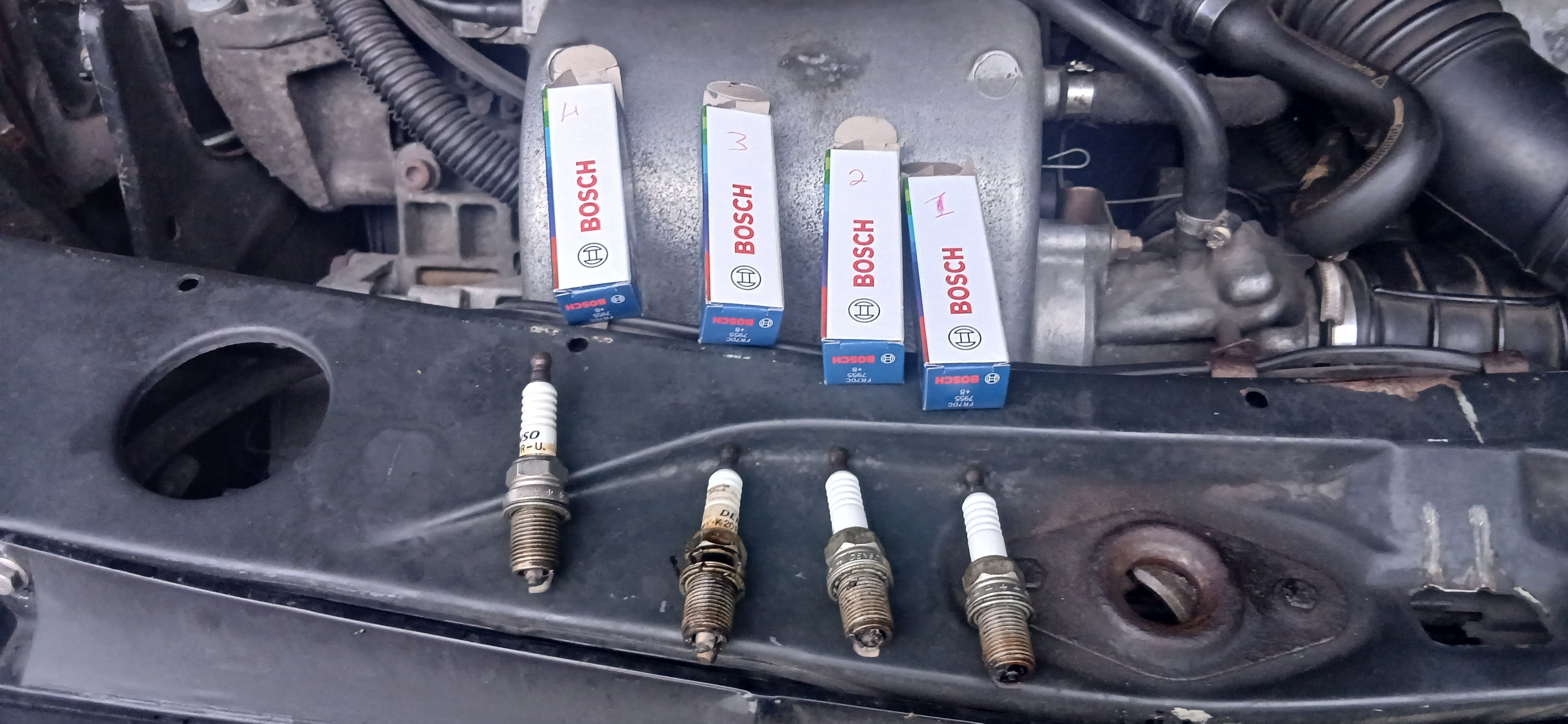

Also check the obvious stuff HT leads , plugs, dizzy cap, rotor (as mentioned above). If they're due a service it'll be worth changing them anyway.
